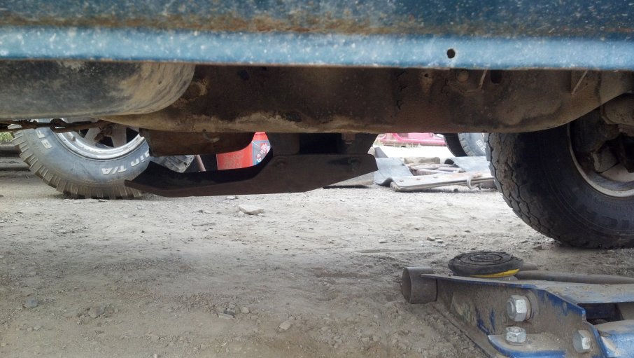

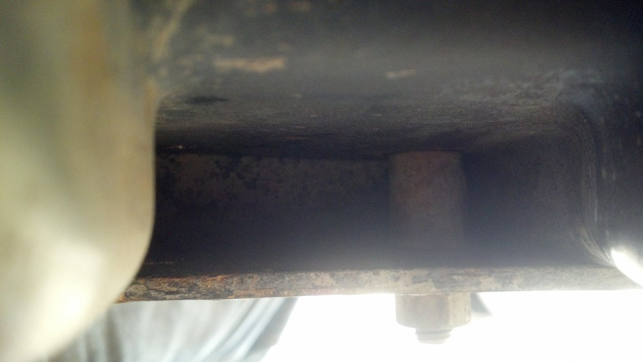

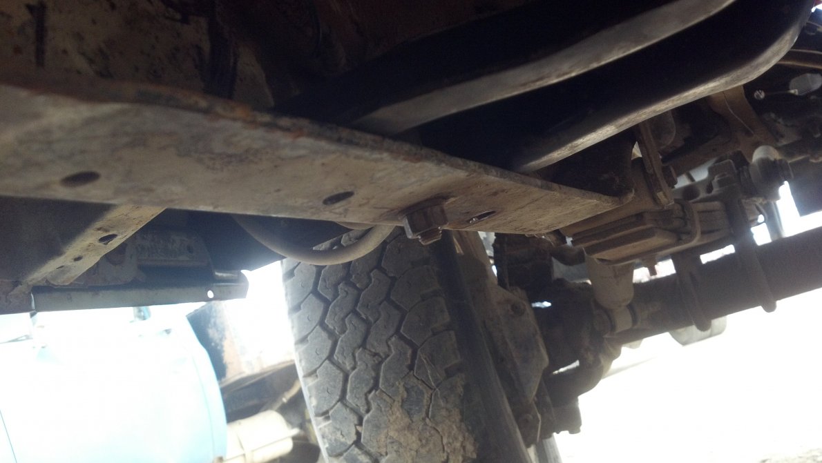

after thinking about it just moving the cross member to the inside of the frame you could use the spacers on the bolts between the cross member and the frame to fill the gap and you would gain about 1.5''
I go back to work tomorrow when I go on days off again I will mess around with this again and see what I come up with

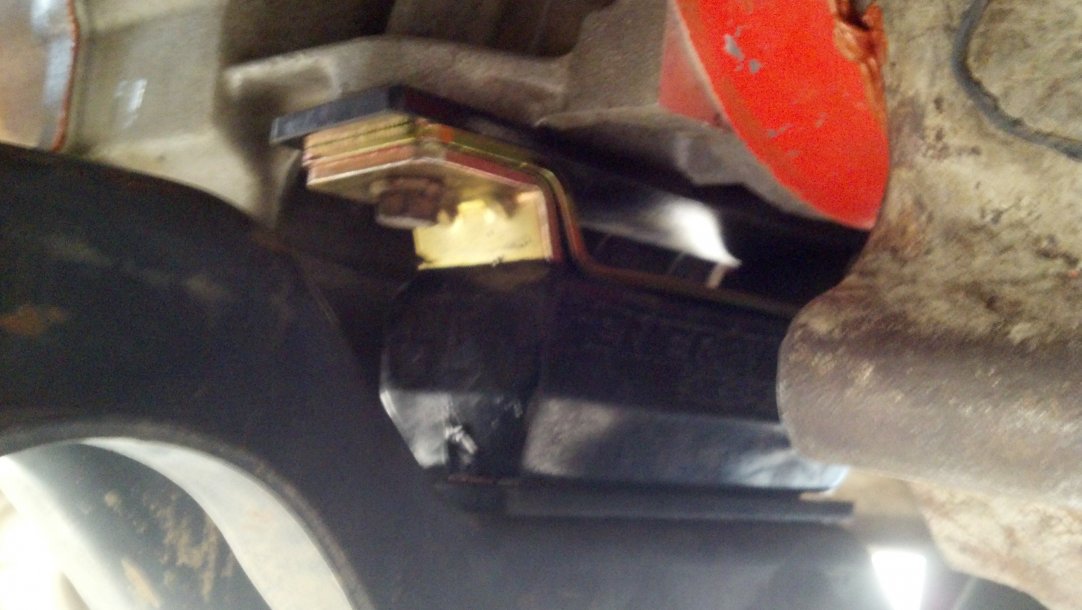

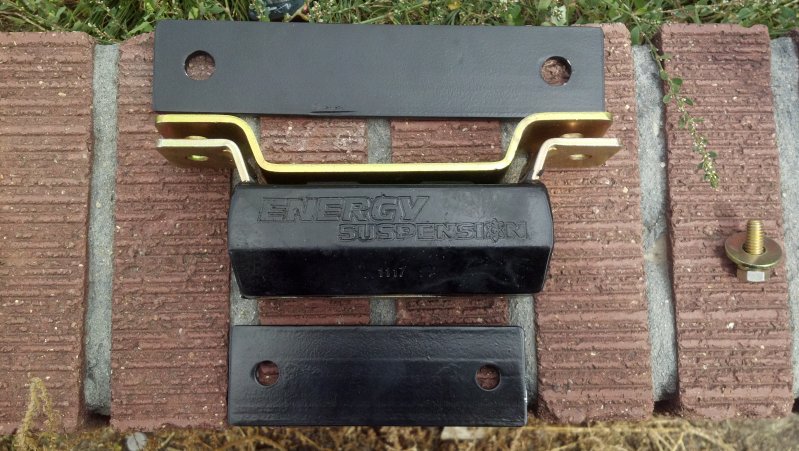

I wanted to get mine together and in the truck on this set of days off so I went the easy fast way
