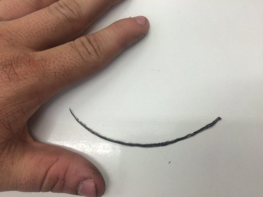

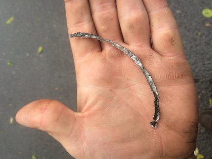

found aluminum shavings about 4 1/2 inches long that are curved
Any chance of posting a few images of what you found. I've never seen - or heard of - big pieces of metallic debris in the pan of an engine that hasn't suffered a catastrophic failure (i.e. has not spun bearings, thrown a rod, etc.) and was still able to run.
Sorry man, we all sympathize.
I have. 4 cylinder Isuzu engine lost the thrust washers and allowed the crank to move back and forth wearing the ends down. Ran like a champ with 300x miles

There was about 6 or 7 of these in the pan

Talked to an engine shop and they said it is most likely a spun cam bearing as they are jacketed in aluminum

That does not look good. Hope your engine is still rebuildable.
