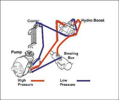

Plumbed the way I thought was best with a cooler in place.
I have the return line from the booster going through the cooler and back in the PS pump res. Then the return off the steering box to the second port on the PS resovoir. As shown in the attached diagram.

the highest velocity fluid return should be the lower port im pretty sure

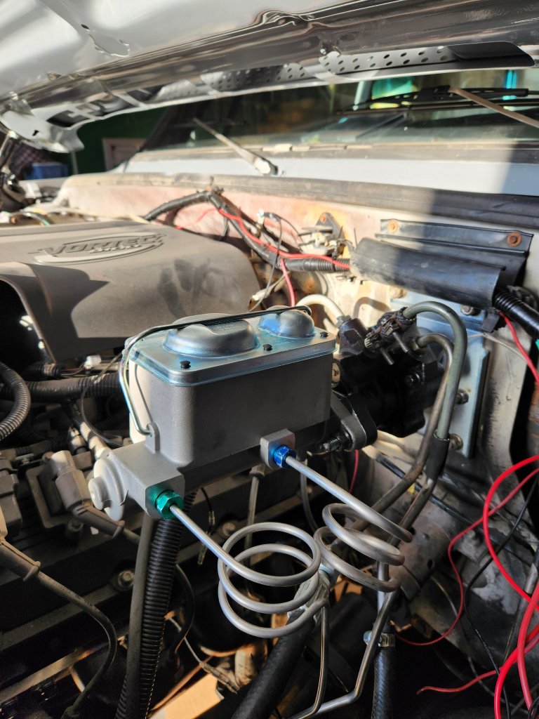

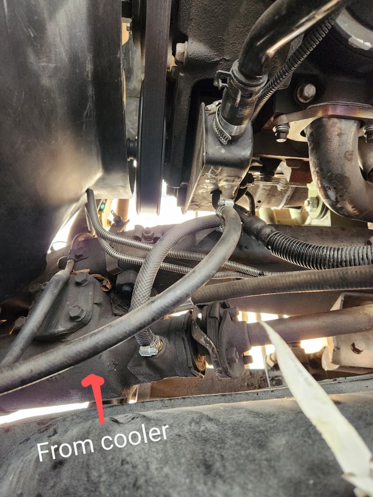

I don't seem to have the "self apply" thing happening. But it's good to know that's a thing happens on that gen of engine.
I can definitely throw a new PS pump at it. In my quest of building this thing everything else is new. So no worries there. At least it could knock out a variable before I warranty out the new hydroboost.
I snapped a couple photos. Nothing fancy. I can grab some others if I'm not showing what you're looking for.

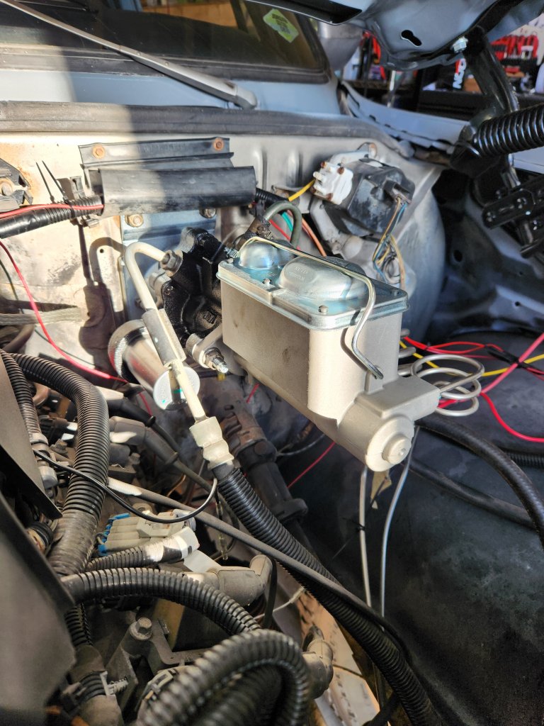

Third photo is yours, i just did this to compare myself.
last two photos are from my 2005, just because it has a cooler plumbed in

On the '05, does the booster low pressure line go into the PS reservoir, or the cooler? I have mine running out to the cooler and the steering box one goes right into the rear/lower return port on the PS res as can be seen in my photo. I'm wondering if I switch my lines around if I might see something different. Hard to find diagrams and photos online of exactly what I'm needing.
Just spit balling random thoughts. I figured it didn't matter as it's all one big loop. However, I'm wondering if the ports do matter in which return they want to see. Possibly to help dissipate any turbulence/small air bubbles the system generated by giving the fluid some pool time in the reservoir. Probably over thinking it. Just hard to figure out when the steering works just fine and it's only the brake side acting up after extended driving. Just trying to fully understand before I start slamming new parts at it.

These are from the repair manual for 1987. Maybe these
will help.
I only sent 2005 ones because it has a cooler in the circuit, and his hydrboost appears to match more the 2005 than the original hydroboost setup in these trucks
