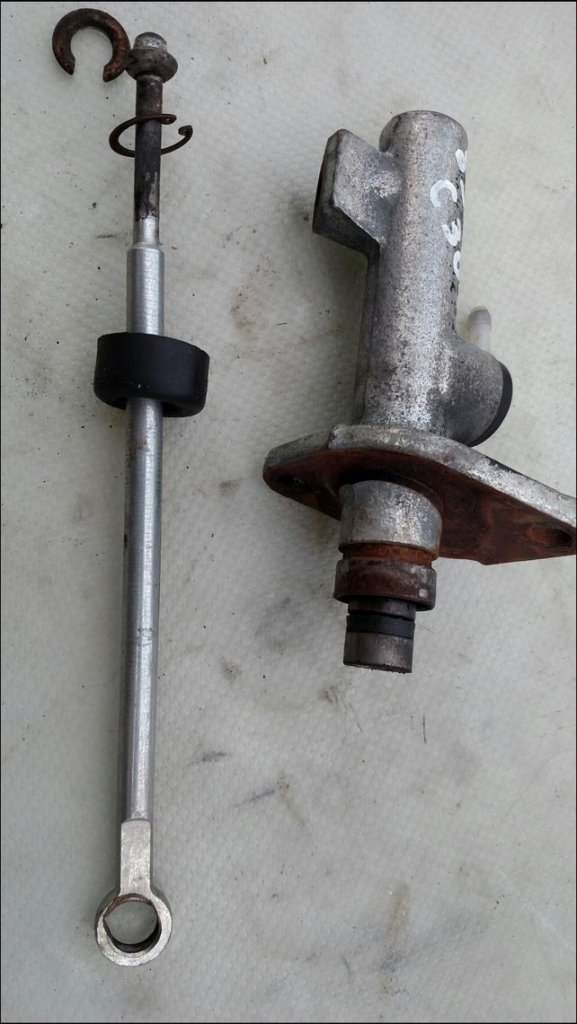

Good start. Replace the plastic bushings in the cross pins. I can see the post on the pedal is highly worn. You should weld that up and file it down so it's somewhat back to normal. I went full on nuclear with mine. Machined new stainless steel larger diameter crosspins, heat treated and polished. 1/4" thick nylon bushings and replaced the pushrod post with a 7/16" bolt. Cut the end of the master cylinder pushrod and welded on a 7/16" rid end. I have zero, play or deflection but more importantly I'll never have to deal with it again. I'm too old to be working under the dash at this point.

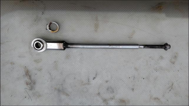

I found the pics of the clutch rod modification. I cut off and drilled out that worn out post on the pedal. A 7/16' fine thread bolt was tack welded in its place. So the rod end now slips over that bolt and secured with a nylock not. Eliminates the pin wearing out in the future. Did the same thing with the brake MC pushrod. Since the crosspins that hold the pedals on were corroded when I removed them, I replaced them with Stainless ones I had made. The paper thin plastic bushings the OEM used were replaced with 1/4" nylon bushings I had made. My machine work labor was free so it was worth the effort.
Not sure I can find pics for the mods to the pedal cross pins. Might have to use your imagination.

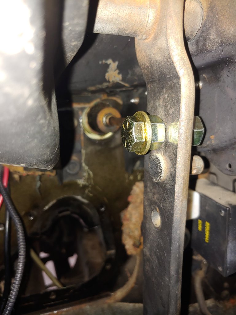

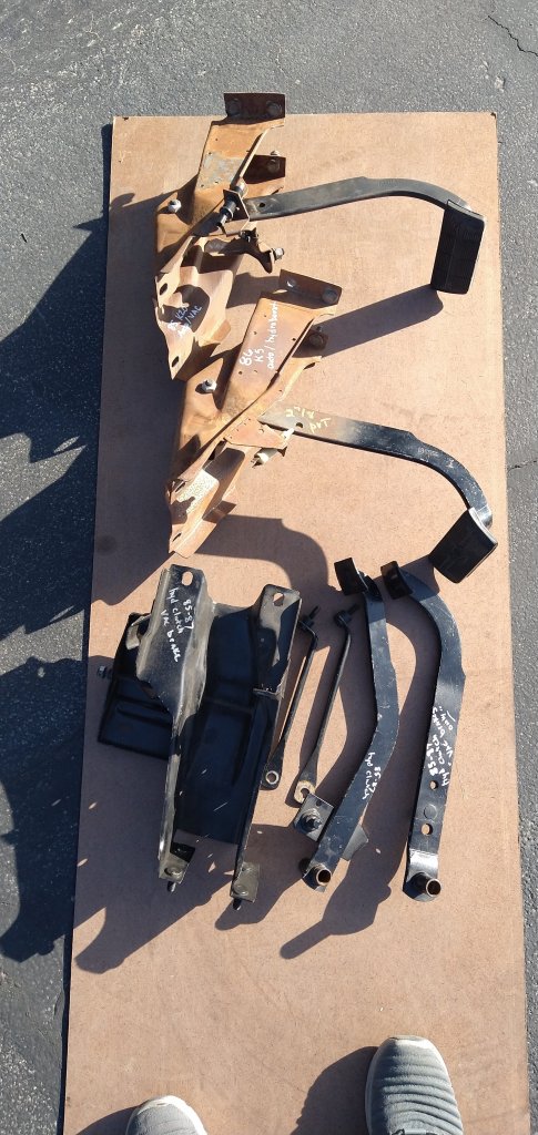

Feel like I should start a new thread....but then again....maybe not. My NV4500 swap is mid swing. Probably overlooked some stuff in my haste. The flywheel I got with my swap was def for a small block. Just got the proper one. And like, I knew there was some bogus wiring in the dash....but.....this is some bull poo.
Now.....
This pedal stroke looks off....do you need to move the pin? Am I good to just put a bolt through the upper hole? Are those pins readily available? Anybody know a P/N? I'm sure knocking that pin out wile in truck would suck.
The clutch stroke lines up nicely I think.

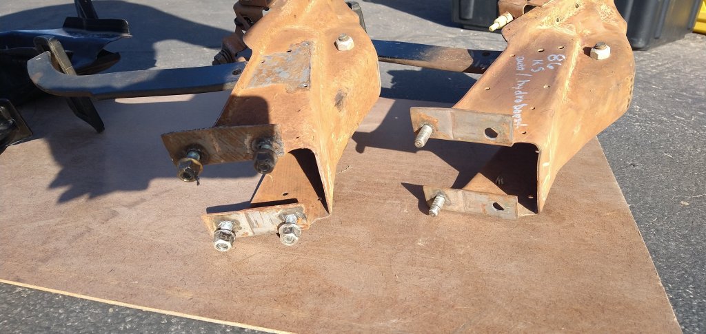

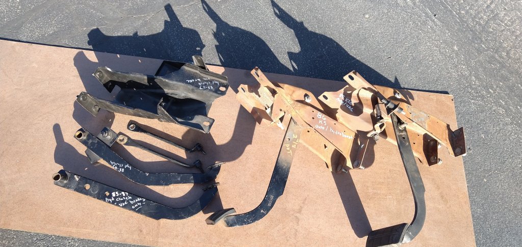

The brake arm pin is different locations between a vacuum booster and a Hydro boost. Is the donor the same as yours? You can tell by the mounting bracket. One has 4 bolts (studs) attached going in the same direction and the other has two going the opposite direction.

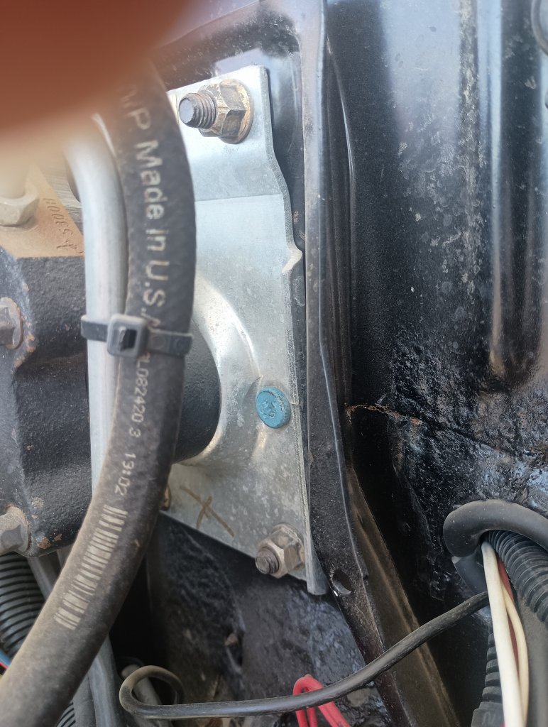

Update. I just went out and looked at mine. I can't see anything on the inside. But from the firewall side, does your bracket mounting studs look like this? Mines hydroboost. If it were vacuum, that middle stud (blue head) would be facing the front and that's what the master cylinder would mount too.
Update #2: Found these pics on my phone. That last photo-that's your huckleberry.

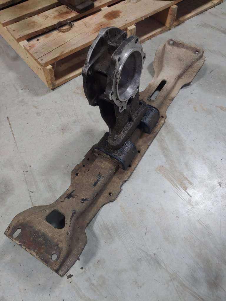

This is the cross member that was in my truck. I dont know if it was original to the truck. That is an adapter for the cucv th400 to NP208. Guess its kinda pricy, but useless to me now. Pretty positive that this cross member won't bolt up to the NV4500 at least not without an adapter of some sort of adapter
X
now this other cross member came with the sm465 swap. was cut up and cobbled back together.....i assume to fit their exhaust...but now it hita mine. Can anybody tell me for certain which cross member I need?.

the short foot adapter on the curvy crossmember will give you better exhaust clearance and is stronger design adapter (if your Nv swap uses the adapter as is?) you may have to move the crossmember foreward or back in order to match where the transmission demands it.

Sorry I wasn't seeing this thread for some reason. A couple things; You may need to swap the brake arm for the one with the higher pin location to get the geometry correct. Or, remove the existing one and modify it.
I don't know if the 85 and 85 crossmembers are different or if they are different between the K10 & K20. Mine has the "W" style. With the NV4500 there is no adapter anymore. The mount on the trans rear housing uses the factory NV4500 mount and bolts directly to the X member. I also had that adapter/foot thing on mine for the turbo 400-NP208 setup. It has value. I recently sold it on FB for $100.
Regarding the pilot bearing. If you have a mic, the input shaft tip should be .590. If the bearing/bushing has any play when installed on the shaft, replace it now. Trust me on this. The input shaft is fairly easy to replace. You don't have to disassemble the trans to do it. You run the risk of hard shifting otherwise and it's a LOT of work pulling everything apart just for that bearing.

Im looking for one of the W cross members now but not looking very promising. So sad that the one I got with my swap was all cut up. Really wish I'd worked on or even looked at one of these trucks that hadn't been completely molested. My ignorance has been the hardest part of this swap to deal with so far. The labor has been breezy.
Will probably end up just making a spacer for the flat member that came out of my rig. Will at least guarantee that nothing interferes with my exhaust. Although.... I'm pretty certain the W would not interfere either. Generally speaking I do try not to "fab" what already exists if it can be had fairly easily.
As far as the pedal goes. Ive not found a single pedal that has the pin the proper location. The pedal already has both holes in it. So we are just making a custom pin for it grinding down a grade 8 bolt.
