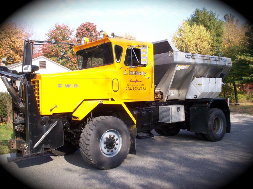

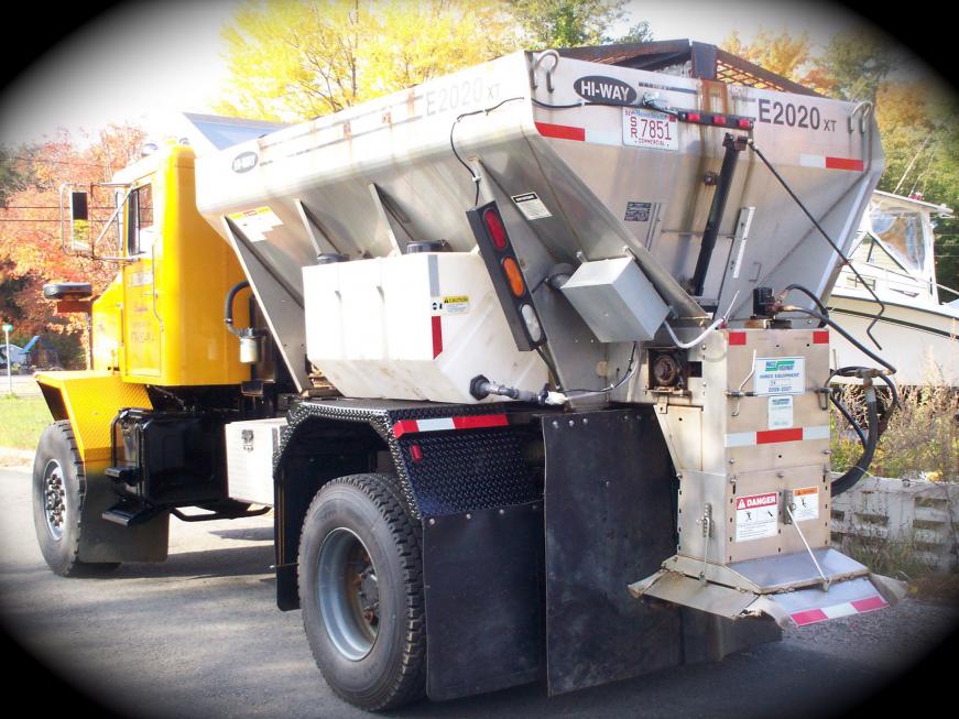

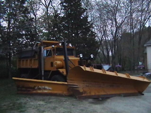

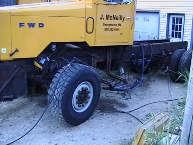

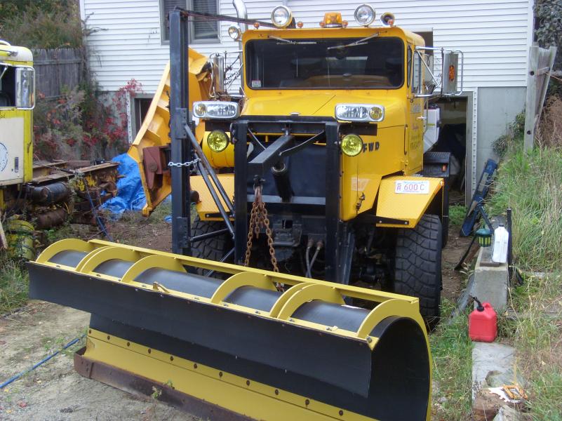

I have a new cab project that has some surface rust.I have blasted them 3 years ago then used 2 coats of POR. Then painted it with 3 coats of good paint. but it still came back. I need help here i need this to stop.
In some places i blasted then primer ed it. but i didnt wanted a nice finish so i filled the blasted rust with green filler. then 2 coats of POR. then paint. but it didn't last 1 year.
Its not quite a square body but it has some square corners.
pic is before and after 4 years ago after it was done up. The cab needs to be done again.
