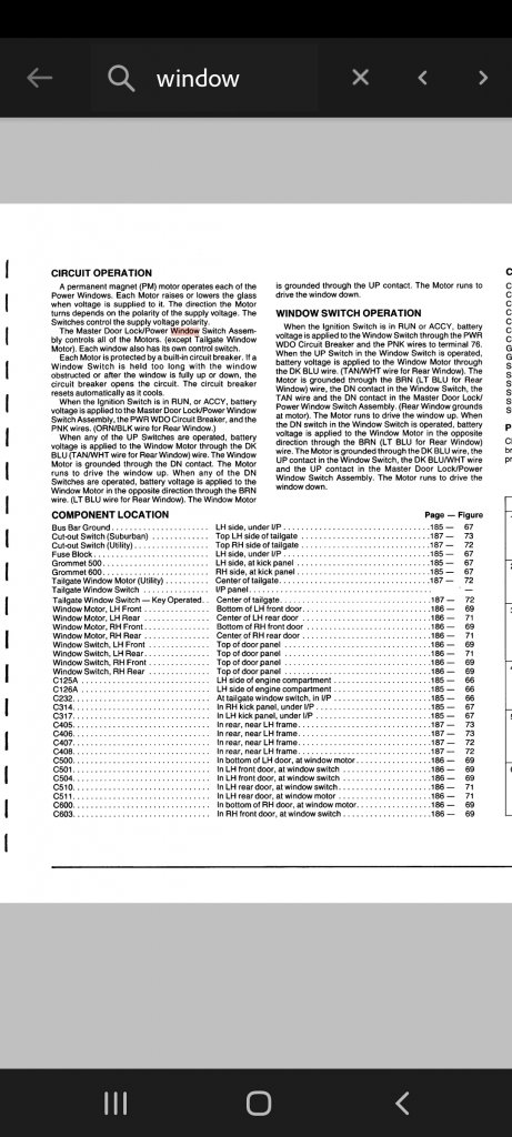

I searched and found this, but I think it's for an 83 model. Maybe it's the same as 87? Anyway I'm not so good at reading electrical schematics. Looks like the passenger side switch is at the very bottom but I'm not certain where to plug in the volt meter prongs to test the voltage. Or where to send power. Thank you

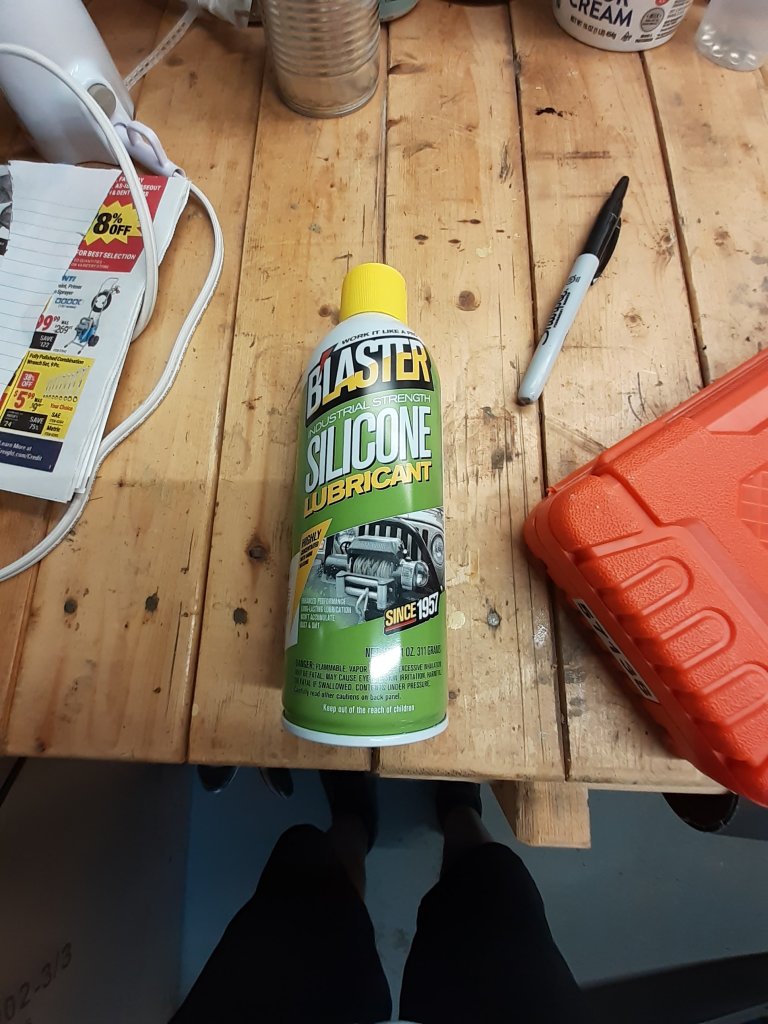

Try silicone spray first. Helped a lot on mine. Just spray the channels with the window down. If the door panel is off you can also spray the bottom of the channel.
Unfortunately it had no effect. Makes me think I got lucky on the driver's side. Works great after installing a new AC Delco motor and regulator.

Looks like I need to feed power to the brown wire, and then the blue wire. Someone said the pink wire also carries power but I think it's just the main feed to the switch. Then electricity goes from there to the brown wire or the blue wire, depending on whether you press up or down.

pink is constant power with key on. ground always goes back through the master switch. power is switched between the other two wires to move the motor up or down with the switch. one of the wires will be power and one will be ground. it reverses when the switch is reversed, moving the window the other direction. if you have 12v on pink, the switch is getting power. if the other window works, ground is good from the master switch to the bus bar by the e-brake. check voltage to ground on the blue and brown wires when moving the switch up or down. if it is a solid 12v, then the issue is a bad motor or something is binding badly.
So if I take your meaning, you're saying there's no need for me to run power to anything. Just check those two grounds?
Sorry about all the noob questions, I'm something of an electrical newb.
