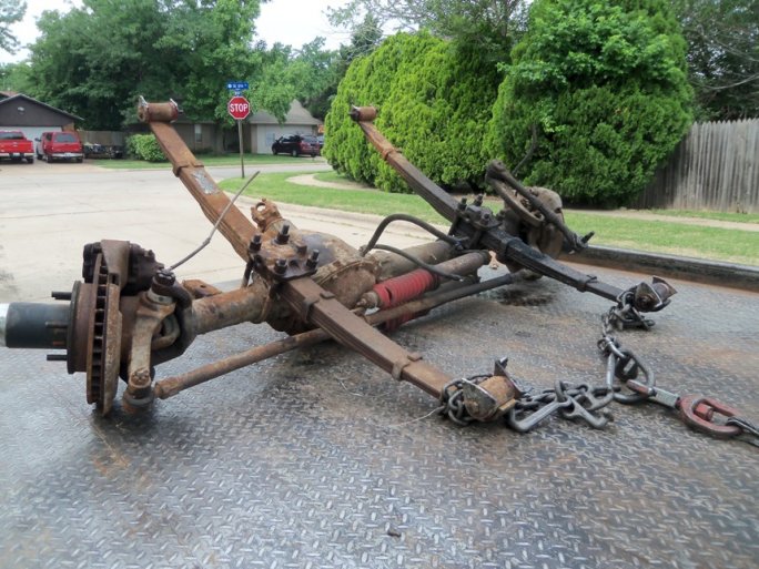

Lift blocks are most common in the rear, so you might still have stock springs back there. Either way, you want to replace the pair, not just the broken one.
If you don't have lift blocks in the rear, a picture of the front spring arch will help get some opinions of lift amount. A negative arch is stock, a basically flat spring is about 2in lift, a slight positive arch is about 4in lift, etc.

Looks stock to me. Front springs have negative arch.

when the leaf spring bends down towards the ground at the ends, that's negative arch, when they curl up, that's positive arch.

You can lift a squarebody up to 3", and not need any steering correction. Anything above that you'll need some kind of correction. Best way to tell is, looking at the springs, tire size and fender clearance. I've seen stock trucks run 33's, and that's pushing it. Or you can check and see if there's any part #s on the springs, and look them up, then you remove all doubt.

For what it's worth. My truck with 8"front springs runs 17" from top of axle tube to bottom of frame. My friends 77k10 w 6"lift measures 15". Not sure if that's gonna be proportional for all lift sizes or not. Mine has 454 his has 350. Mines 1 ton his isn't...
