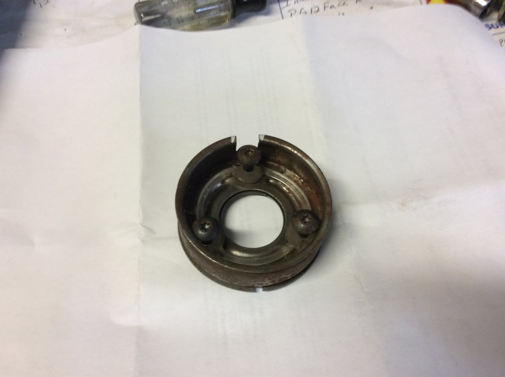

so after the turn signal install, I want to make sure the horn is working before I put everything back together. If I push the little plunger down on the turn signal switch down should the horn sound off or am I missing a ground of some sort with the lock plate not installed?? I know there is a little contact under the turn switch,next to the screw that hold the key tumbler in place. any help??

not sure myself, just thought maybe the horn would work just by pushing that little plunger down by hand, it may need to be grounded,then pushed

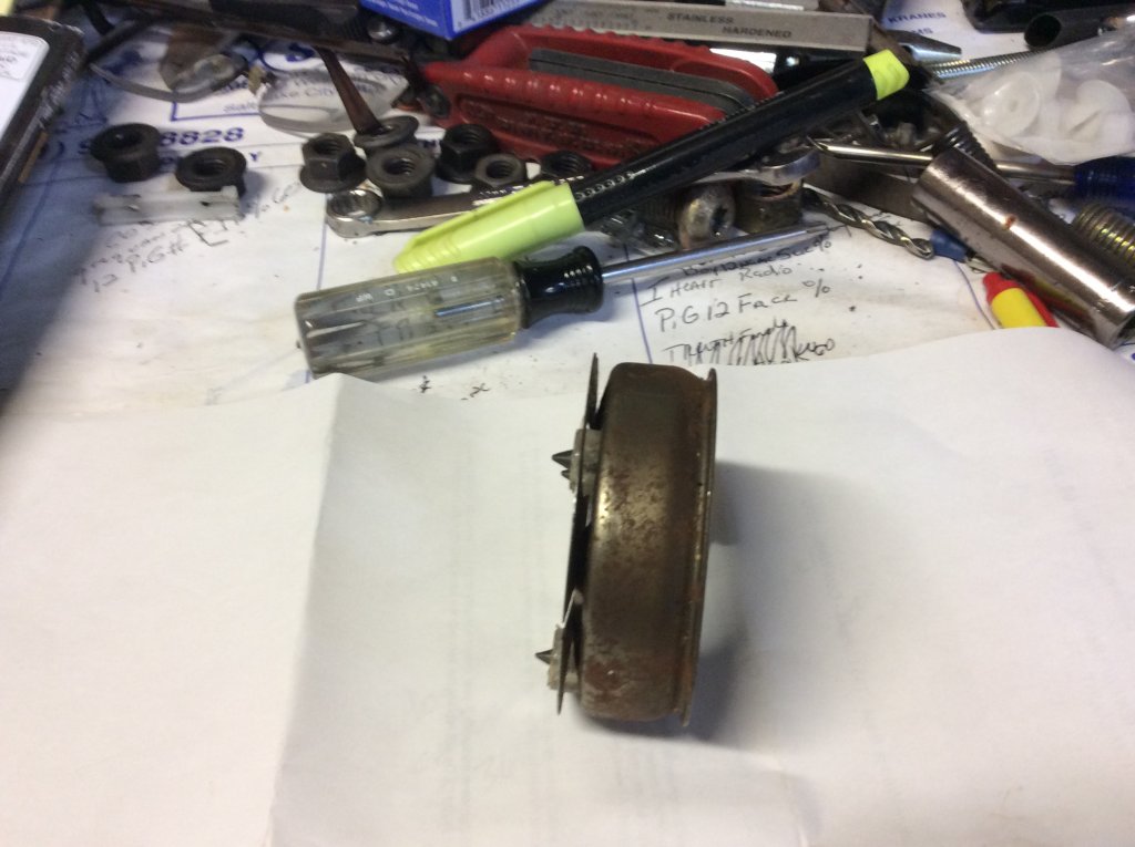

that plunger rides on the turn cancel cam on the bottom side

The little plunger needs to be grounded to get the horns to work.
If the horns don’t work even with power applied directly to the connection, give them a light tap with a hammer. Sometimes that will get them going again.
