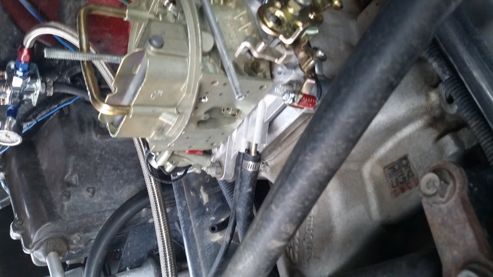

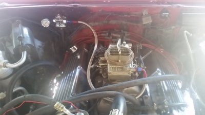

I got the new carb and put it on runs strong has an initial bog im figuring out through jetting and power valve combos theres alot of tuning that can be done. I put 87 jets in and kept the 25 p v in and a 40 discharge nosle in it runs good but am going to try 80 and a 45 power valve and 40 dis nosle. Im ordering a jet tuning box so i have all of them to try and figure it out..we will see .......

Oh my electric fuel pump is crappy the pressure is never the same so going to put a holley red on it after i get back from ohio in three weeks. So it gets consistent fuel presure

So i put a new pump on it this weekend and still shows 6-7psi on start up then drops to 3-4 after pump gets warm. Idk whats wrong its a 14psi pump im going to move some wiring around to see if it makes a difference. Also I put the hollow screw in the discharge nosle made a huge difference. Went to the white spring on the secondary diaphragm much better on the freeway..

So i put 80 jets 5.5 power valve small yellow spring for secondary and it runs like a champ. But now have a leak in the base plate i just switched it out tightened everything up and ill see tomorrow if its leaking still. I also put a phenolic spacer on to try and keep some heat off it we will see how she does.
