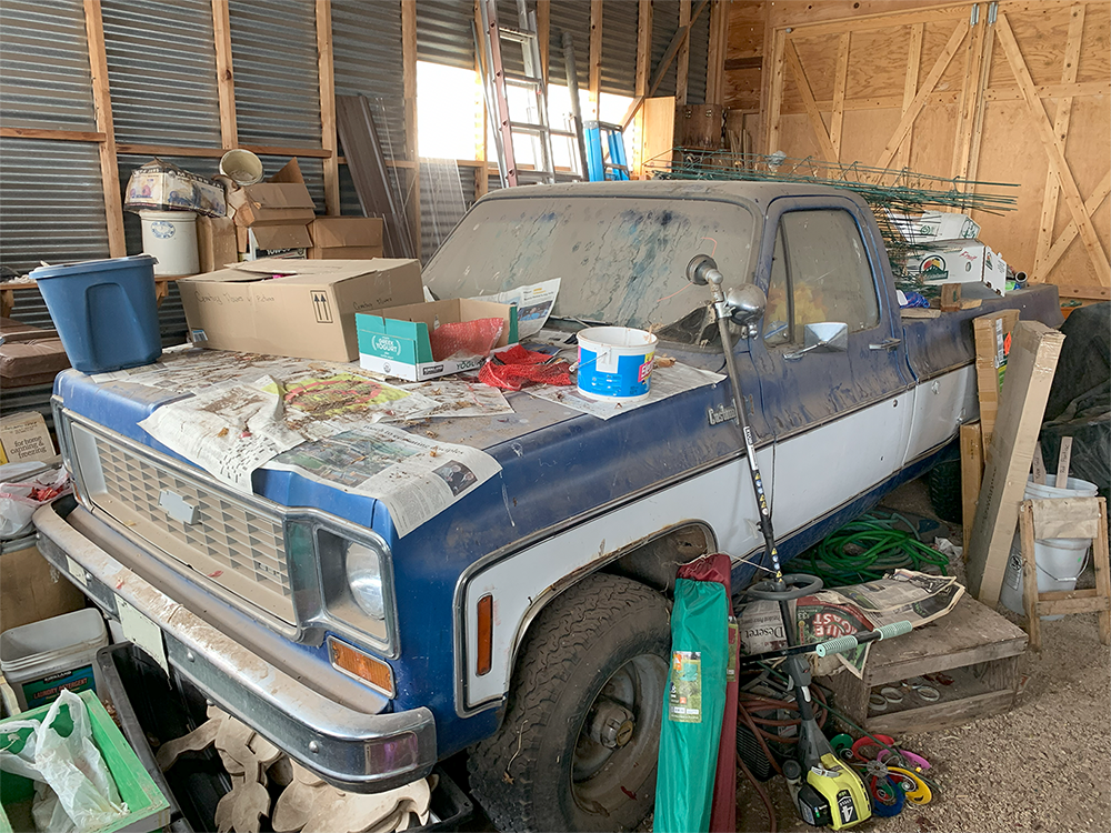

Thanks everyone for the quick feedback. After thinking about this some more, I have decided to look into a trailer and haul the truck back to my place. Too many things can go wrong on a 4 hour trip with a 50 year old truck that hasn't been run in years. I'll pick up a battery, oil, and filter, and hopefully get the truck to start so I can drive it on a trailer.
I don't have much for pictures yet. All I have is one I snapped a couple of years ago when I was at my Dad's place. I wanted to buy it from him then, but he said, "No, I'm still driving it!" My Dad was 96 at the time and hadn't driven any car in several years. It does have some rust as can be seen in the photo. I don't know how extensive. I'm guessing the mileage is something south of 120K.
Thanks again for the tips on battery and filter.
