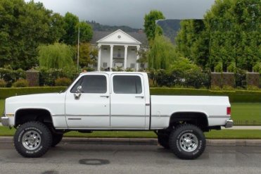

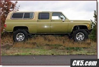

I am not too concerned with turning a LB to a SB. Just cut frame and reweld and sell LB and buy a SB to put on. Airbags have me more concerned as I will have to 4 link everything. As for what I want to do to a burb, blazer back half and lengthen wheel base that would be more fab but if my photo shop uploads loads up correctly it would be awesome and if I wanted to truck it later I could leave the wheelbase and use a cut down short bed between cab and wheel like the new crew cabs
I have though about a new truck but anyone can buy and drive a new truck.

Photo shop of cut down long bed (late model front end)
