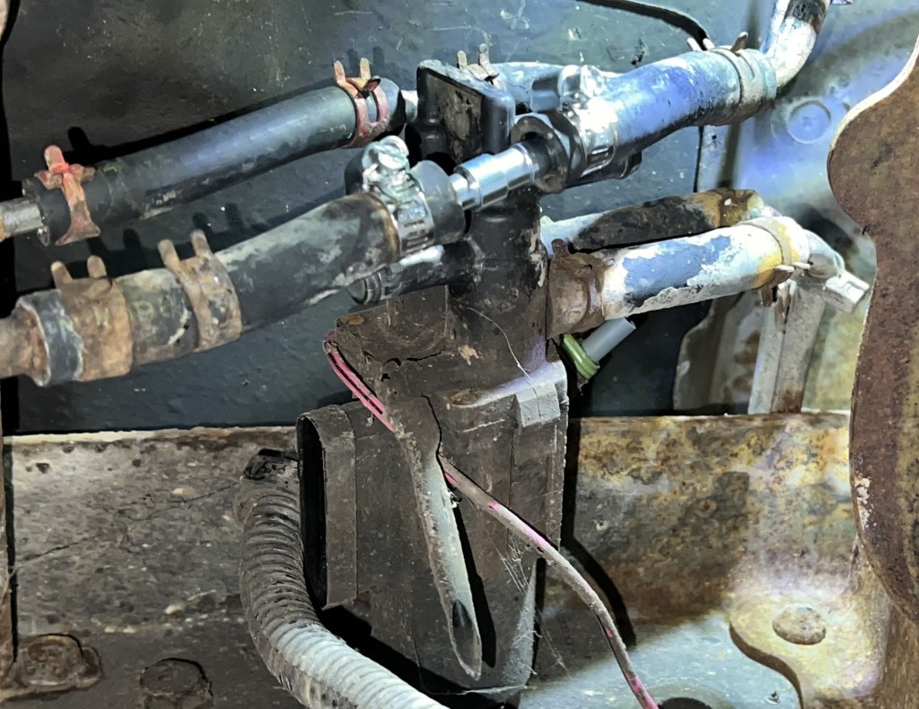

Passenger side frame rail at the back of the cab trace the fuel lines from the tank to the valve pop the lines off the valve from the tank your going to use for testing and hook them up to the steel lines running up front

Passenger side frame rail at the back of the cab trace the fuel lines from the tank to the valve pop the lines off the valve from the tank your going to use for testing and hook them up to the steel lines running up front.
I did it and now it won’t run. Even blew out both feed and return lines. The driver side tank was empty when I first went to syphon and I did notice the passenger gas cap was missing when I first started working on it. Would I go to sending unit at this point?

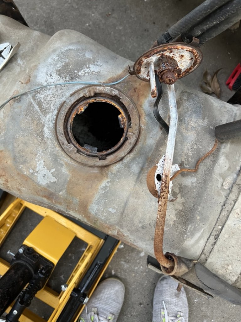

Could be the sending unit rusted away if it runs off the bottle and lines are clear and fuel pumps good only thing I think it could be not getting fuel from the tank I have a electric lift pump so maybe it needs to prime try squirting a little fuel down the carb to help it prime

Yeah, I should have mentioned that. I did prime it with gas and it ran a few seconds and it just died a few seconds later.
The vacuum line was cut from valve, so maybe last owner tried to disable valve, but it was sender. Idk

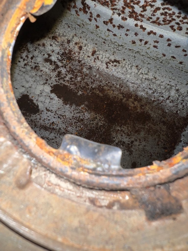

Boy was it all rusted. lol
