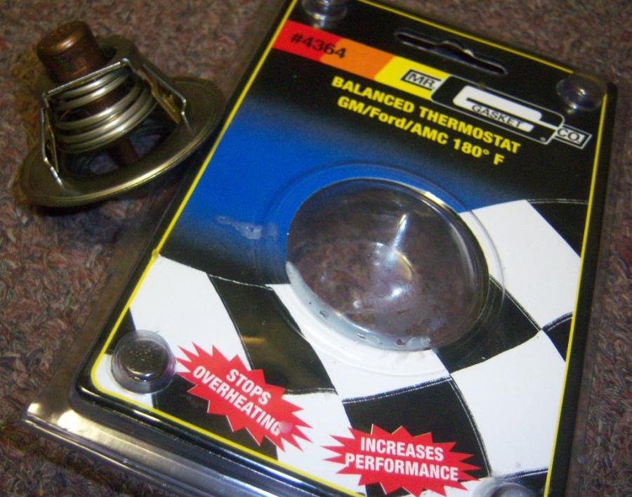

Speaking of which, its a nice warm 45 degree out right now, and I need to go install a new thermostat in my truck. I use failsafe thermostats, and mine is stuck open I beleive. I can't even get my truck over 100 degrees at 80mph. I finally put a piece of cardboard over the grill to have some heat. It worked, but time for a new 180 Tstat. Be back shortly !!!

I'm not going to jack your thread here Clean, but just to say, I did fix my heater now. Took all of 10 minutes to swap Tstats. Sure enough the failsafe Tstat was stuck wide open. I replaced it with Mr Gasket Balanced Tstat and I do beleive they are also failsafe. $8.99 at Auto Zone.
attachment.php
BTW, this is the package to the new Tstat, and you can clearly see the old one that is stuck wide open. Truck is blowing air now within about a mile to a mile and a half.
