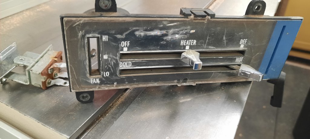

The control on this web page is what I installed. It is, exactly, like the one that was in my 78, but this one has four switch positions.
Switches run around fifty, or more, other than what I talked about above, so I just went the extra twenty for a new assembly.
LMC TRUCK
Temperature Control Assy "B"
Part #: 32-0636
SIDE NOTE: The control panel in mine was all fractured. Genius former owners did something interesting. When I pulled the old one, one of the two screw mounts for the switch was broken. This photo is what it looked like.
I don't know if the B unit was for the "deluxe model," or if it was for those with air. Indication is, the four speed is for low, medium one, medium two and high.
If using the four position one, if you didn't care about the fan running on low with the engine on, one could modify the system to add the medium two function for those times high was too much (e.g., loud) and medium too low.
That could be as simple as installing a wire resistor able to handle the wattage and with a value between the ohm rating, for example, a bit less than the medium circuit.
Depending on how you went about it, it might require a different connector. If you wanted the fan off unless you put it on low, you'd have to add a switch.
Others don't care about low and just disconnect it at the resistor.
Anyway, it could be done and still look nice.
When I swapped the dead switch on my 69, I cut and filed the hole the stock switch was in and now one knew anything had been done. However, all it gave me was medium and high.

That first of 4 positions, being the off position for the fan in my modified system, is, exactly, why I went with this switch instead of the 3 position ones it replaced.
Instead of leaving the connector wires where they were, I re-positioned them so position one had nothing on it. Position 2 became low, 3 became medium and 4 became high.
That way, no extra switch was needed.
It remains, as you indicate, another switch would be needed for rigs with the 2 medium speeds [that, also, must have a completely different resistor, to drop different amounts of voltage going into the blower for the 2 medium speeds] to gain an off position.
