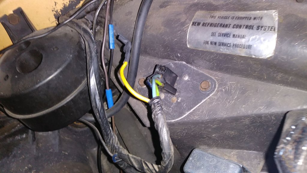

Thanks for everyone's reply. I'm going to install a cutoff switch.
For the blower motor not to run all time, need to remove the upper wire from the connector on the resistor. Mine is the yellow wire in the pic.
Strange... what wire is that meant to be? I wonder if that applies to all years or no ac, ac
I modified mine by putting a switch inline to the speed switch, found a way to do that on-off lol
That is the LO speed for the blower. If you have 4 speed fan switch with no off position. Other years may differ. I do have AC but not sure if that matters.

I'm going to try removing the low speed feed from the resistor module. Low speed is not going to defrost a window.
So unless im reading the diagram above I posted wrong(heat only 1979) , I think the wire you are looking for is brown? I dont recall what color mine is, but im not checking lol..
There are 2 brown wires to the blower switch, and best I can tell the one that goes to the bulkhead for the blower motor is the one needing a switch. but do check that to be sure.
