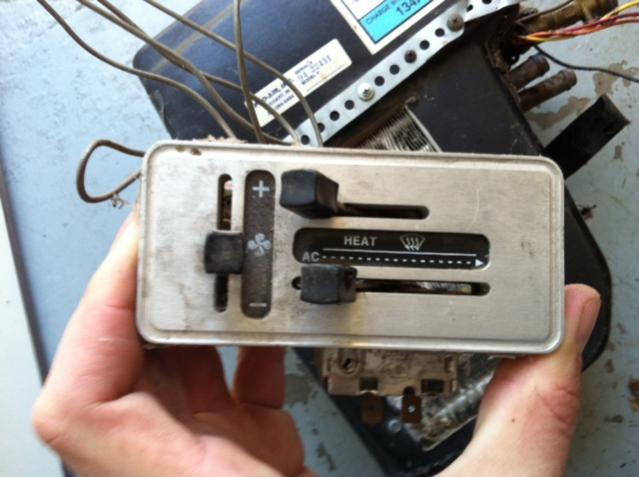

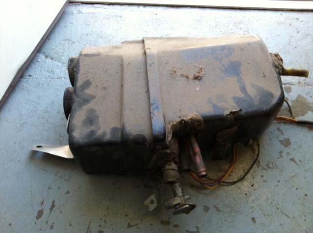

I started talking to an old guy at work today that builds a lot of hot rods. He asked me how my truck was coming along and I told him about this heater/AC box issue. He said well I think I might have a AC/Heater box setup that's all self contained and all goes behind the dash I used in an old street rod. He's supposed to be bringing it to work for me tomorrow. I'll post pics of it with the brand and part number as soon as I see if it's worth using.

It's a pro-air AC and Heater setup for behind my dash. It's pretty old but works great. I think I post more about it on my build thread title "Southern Belle". Enjoy!!
