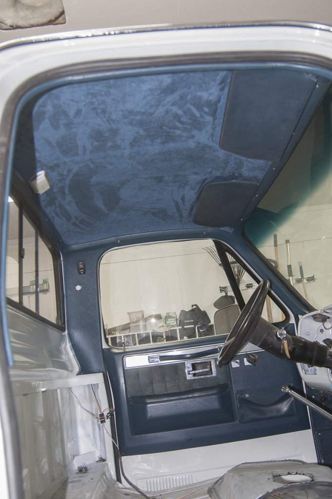

since then a made 2 other headliner with the same stuff! :)

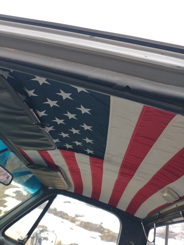

a few weeks ago I was going to pull the trigger on a headliner from LMC but just couldnt get myself to pay that damn much, so I gave an attempt at fixing mine, it has wrinkles and isnt nowhere near perfect, but that foam crap doesnt get in my hair anymore
