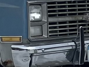

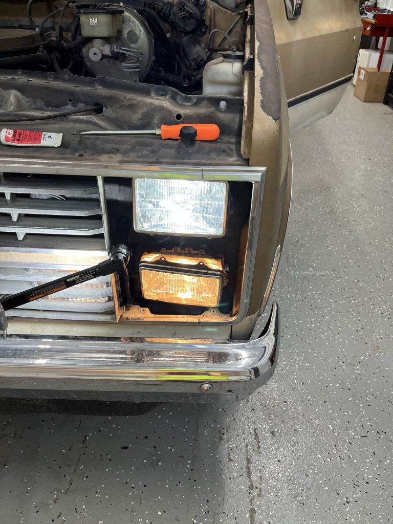

So... I am looking for some information from the group. I am in the middle of bring back the 84 k10 i drove when i was young. Due to the age and condition of the grill, i am going to replace it. In addition, while i'm looking at this i noticed the headlights are only a single 5x7 not 2 4x6 lights like my 84 C10. I know that the K10 had some body work done on the truck in the mid 80's and i don't know if the headlight assembly was originally 5x7 lights or the two 4x6 lights. Maybe both options were available and the 5x7 weren't as common. The blue is the single headlight/dual beam, the other is the 84 c10 with two 4x6's. This is the pic i took when switching from old lights to the LEDs.
my guess is the 5x7 is OEM and dual beam single lights, but just want to make sure.
Any guidance or direction is much appreciated.

'trim' level option.
my '85 k20 super double xtra heavy duty has single headlights.
it's a custom deluxe level trim.
the base level :)
k trucks can certainly have dual headlights depending on the trim level it left the factory with.
good luck!

that is what i was thinking and realized after i sent this. thanks for the quick reply! Where i was struggling was both trucks are the Scottsdale models. The C10 was purchased as a parts truck but after getting it home realized it was too nice for a parts truck...now i have two trucks:rockit:
