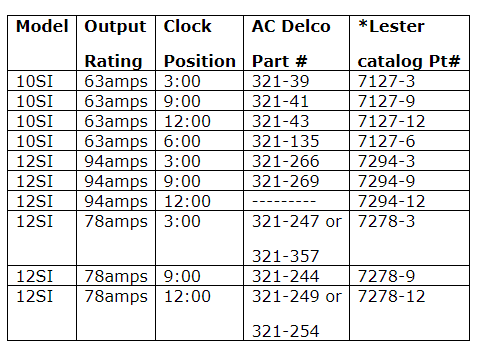

The cs130d and ad230 are very similar so here is one chart for those
The ad230 just makes more at idle and between its max output but not by huge amounts. I couldn’t find a chart for that

This is from a 1972 350 with stock pullies(the 10si on the bottom, ignore the 10dn)

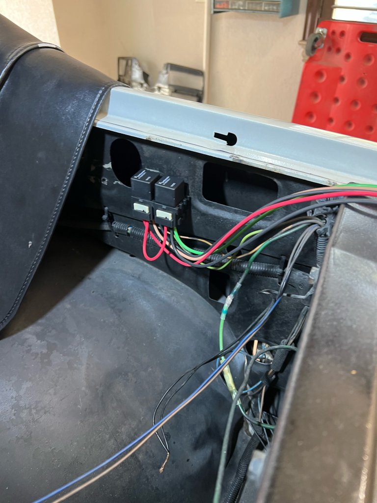

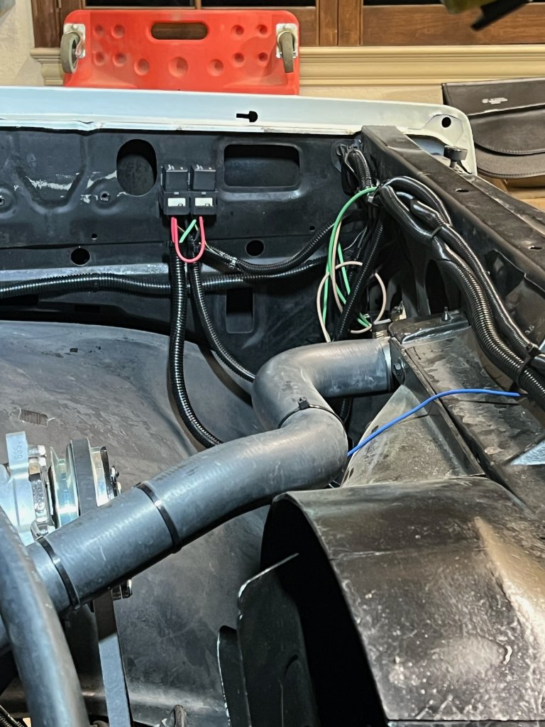

@SirRobyn0 , great thread. Take a look at the American Autowire relay kit versus LMC. We bought both, but the LMC version was “made in China” and the American Autowire was such higher quality.. just our opinion, and we got it on scamazon for about the same price with free shipping!
Best to you sir….

Thanks Randy, I bought an LMC relay kit back when I did the Hella h4 conversion buckets but have never installed it. It's just sat on my shelf. I've come to understand that the LMC kit is not the best quality particularly the relays. People seem to complain about the relays failing. So if I get around to installing the relay kit one of these days I'll by quality relays to go in it at least. If I'd have know then, I wouldn't have bought the LMC kit, but it's what I've got and I'm well past any return deadline.

Just remember, the relay kits the comanies sell can be built, a lot of times for less, at home with quality parts and a little time. Not much more time than it takes to hook up the kit.

There was a video on YT of a guy installing the LMC kit and showing how the wiring they used was chicom-esquely (I'm killer at scrabble, lol) over-rated with more insulation than copper. Then there are some very good vids showing issues with their power window kits also. For the same $ I bought some high grade USA made copper wire and a relay box to put them in. I agree that most all relays that come with these kits are garbage. Replaced them all with NOS German /Spain made Bosch relays from Rock.
