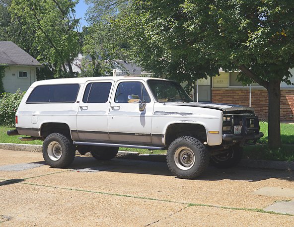

A pic would help a lot, and what size tires are on it now. Most of us could guess within an inch or 2 how much higher than stock it is or what size tires you could run.
stlbob
Nov 18, 2016
56
St.Louis
bobby
91'
k3500 4x4 Burban'
tough room okay let me findhttp://www.gmsquarebody.com/forum/attachment.php?attachmentid=33716&stc=1&d=1483884199 some pics.....um help a guy out how do i post pics..got it.not its best pic..its all oem on the inside..seats are perfect as are the dash door panels carpet ( but has changed into some odd color up front )headliner is toast doing that next..floor mats are oem 91' as is radio..PW PDL windows all work getting the locks lined out..it has the 6in tube steel concrete filles front and rear bumper with channel steel braces going to the frame front and rear..454 .30 comp cam 272 Barry Grant Street Demon 750 VACSEC, Edelbrock intake, Heddman headers true duals Accel everything,400 turbo no stall huge extra cooler for trans,monster Haynes cooler for the oil total oil change 8.5 quarts.

4 inch lift?

thats what it looks like to me..when it was done a place here made all the springs and the owner told them he wanted hvy duty and big enough for 35"..now i have 33x12.50x16.5..yes 16.5..i bought a set of brand new GMC 16.5x9.0 wheels..so i found a place on line that X military tires like 36x12.50x16.5 and can get a very good price.But dont want to order them and have to cut the body..thats not happening will carve up this almost rust free Burabn

If those are 33" tires then that is deff a 4" lift. I have 6" and fit 35s or 37s.

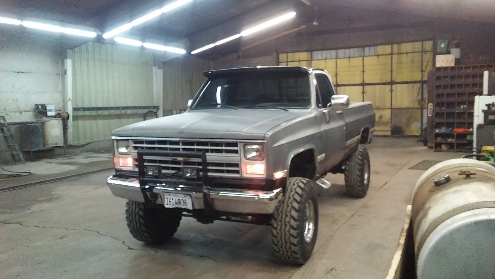

Im running the 36 military love em. 60 miles a day no highway but thats do to 3spd and 410s not tje tires. 55-60 they roll like a dream alpha tread is where i got mine. 90% life they should fit they mesure a lil small.
I actually bought this truck down by you breeze il. Now this is 4 inch susp and 3 inch body

OK ...so im thinking it ended up being about a 4" lift..now it has no blocks it is all spring.I really want to run 35's for a little less hiway RPM..but 87Scotty i found that place you speak of and one more with good reviews. The tires are 36 E rated radial tires like 85/90% tread AND they are 16.5 which everyone tells me i should dump..But i wanted a TRUE 1 ton and back in the day 1 tons ran 16.5s so i bought a set of GM white steelies..I just dont think its tall enough for the 36's...
Anybody running 35's on a 4" ish lift..the nice thing about this was the use of GMC leaf spring mounts all the way around,no short cuts with a wunky shackle only mount..this thing drives so straight down the hi way..so i do not want to FUBAR that trying to cram a tire under it that doesnt fit..

They messure out at 35. but definetly want to know for sure ypu can always shim an inch.

Hay Bob. Wtg, looks cool. Easy 4 inch if it's not 6. No? How do the driveshafts look? 4 is a common SUSPENSION LIFT.
