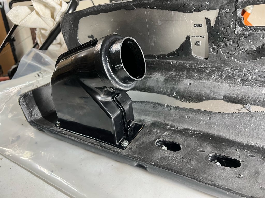

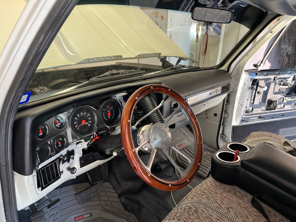

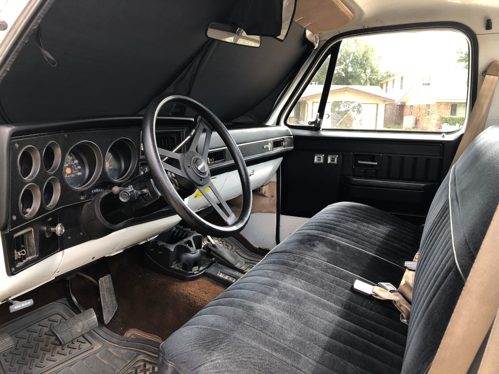

I bought one a while back- It does have metal. It is just okay- maybe... It is too tight around the instrument panel. I eventually got mine to fit decently after a lot of work. Trimming edges and such. I don't think I would go that route again, but I haven't really seen anything better.

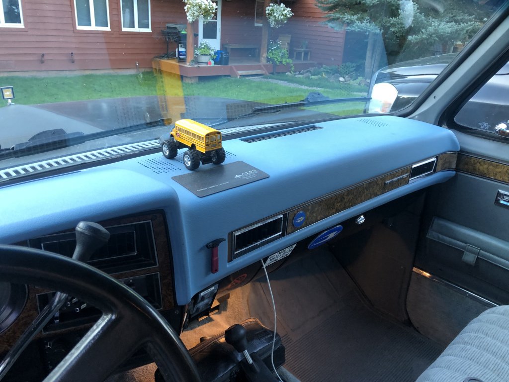

I have a an LMC dash in my 81, fit is fair once you do a little trimming. I live in FL and forget to put my sun shade up half the time, and am the end of my 2nd summer with the dash sitting just fine. I had one in my 85 Ford too, same deal.

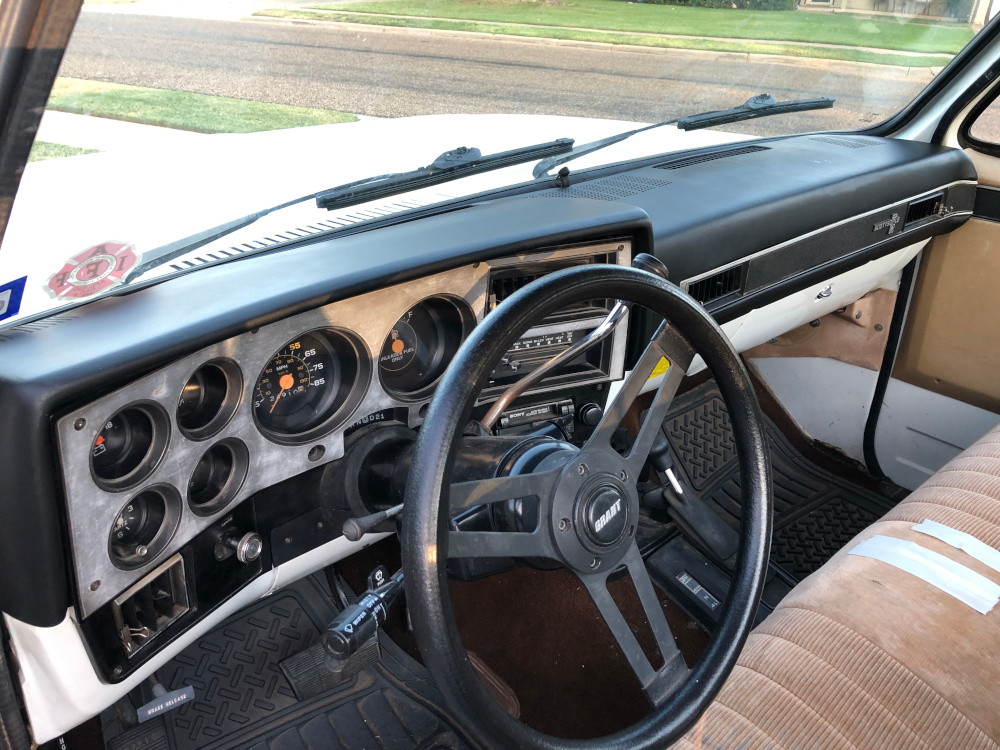

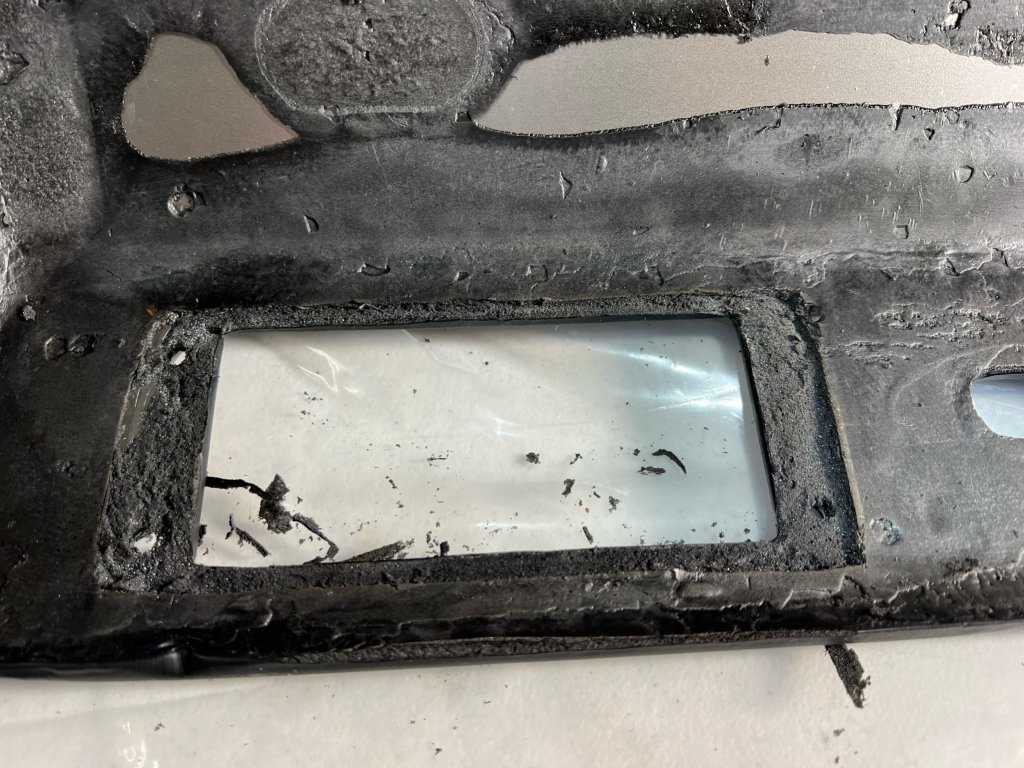

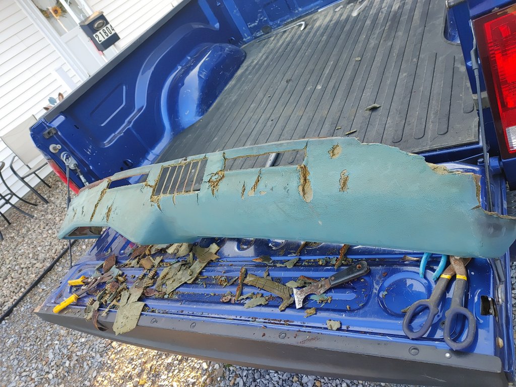

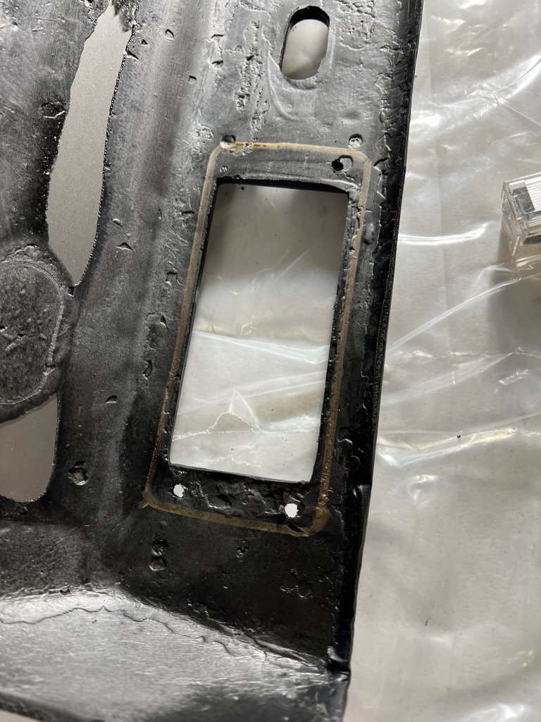

I fixed my factory one. It was pretty bad. I was going to do leather but thought I'd hold off for now since the truck is still coming along. Cut out the rusted metal and patched with sheet metal. Then cut all plastic that was cracked. I filled with some spray foam the sanded. Yhen body compound. Sanded until it was smooth. I did cut out the metal where the factory speaker goes. Not sure if I'll put a speaker there or for now I'll fab a screen of some sort. I covered it with vinyl. Used a heat gun, contact cement and viola.

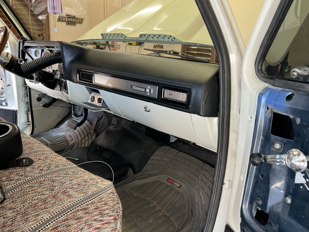

We did the LMC with metal as well. Very happy with how it was made and how it installed in truck. Bezel was not that bad except for drivers right side AC vent was hard to set back in and took a bit of adjustments and then went in fine. We had to trim the foam away from the inside of the passengers vents so the actual duct would fit and the clutch back will grab the bezel trim and hold it in place.
we actually have to take it out because we evidently did not take enough foam away from the inside foam around one of the ducts and the pin from the dash bezel that holds the duct in place sheared off under load apparently. Have to buy a new bezel and to re set the AC duct after we cut some more foam out.
It looks great in the truck but will add a small piece of metal metal on the instrument bezel upper right side to give that screw something to grab there instead of just foam. We would buy this again, even with the issues.

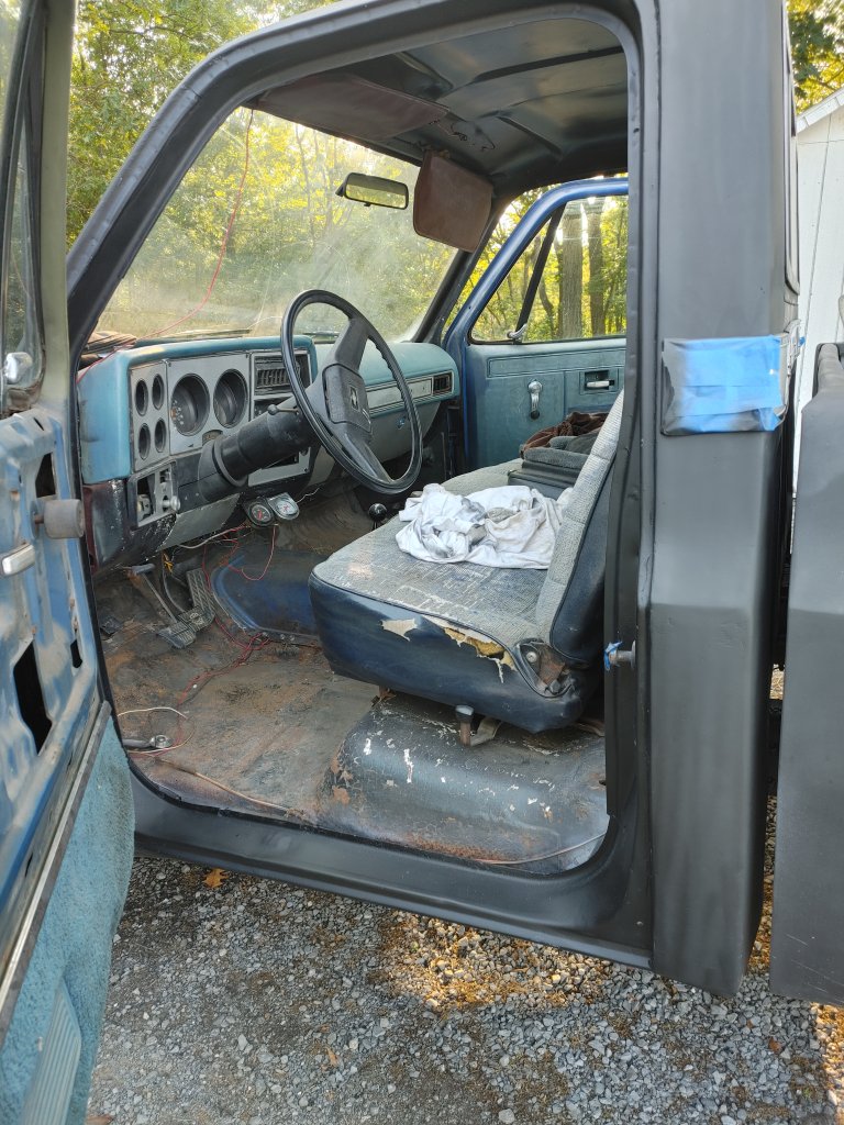

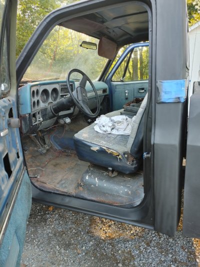

Thank you. The truck is a hodgepodge of truck parts. I figure there 4 different trucks in parts to this one. The interior was red and light blue. I personally love a light brown/tan interior. This is a brown but a little darker than I was going for. The materials cost $50 but could probably had been less buy I have no experience with bondo or frankly doing any of this. Pic of how the truck was purchased.
