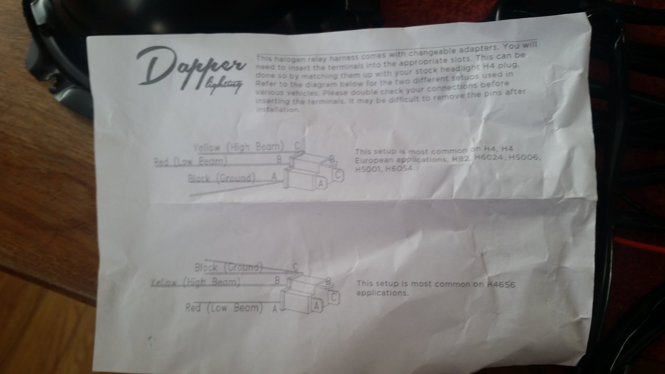

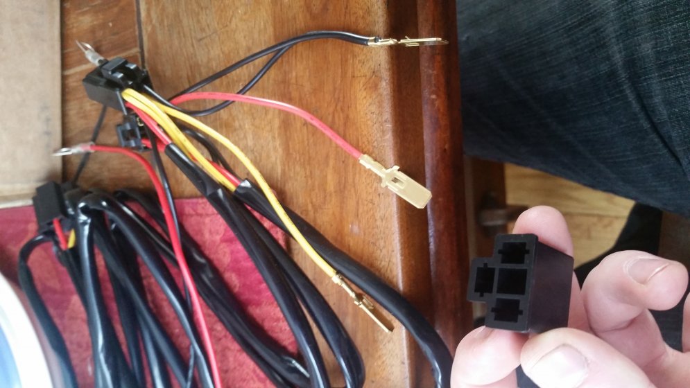

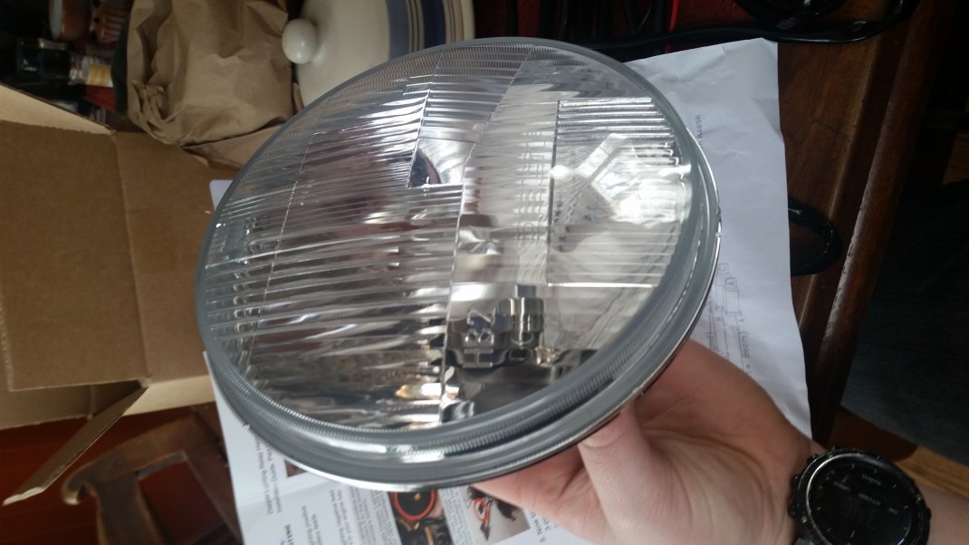

Ok guys i got my new headlight kit from classic industries and it game with the dapper lighting kit. Im not sure how to set up the 3 prong male connector to plug into my headlight harness. I dont have my truck right now its in the shop but i just wanted to get it all figured out. Shouldnt there be 2 male prongs for both oem headlight sockets? Or is there a socket that both headlight sockets plug into? Its confusing me lol, but which way should i set up my 3 prong connector?

Hey there! Here to help you out. There is only one male plug since we just need to signal from your car which will tell the harness to turn on/off or low/high.
Basically one input plug and two output plug.
For the male plug, you just need to match your factory plug Low/Ground/High or (Drive/Ground/Pass) as some plugs label it. Then, take the connector and push it through the plug till it clicks.

Yeah, since both headlights always do the same thing, the signals from either one are enough to run a relay kit.
