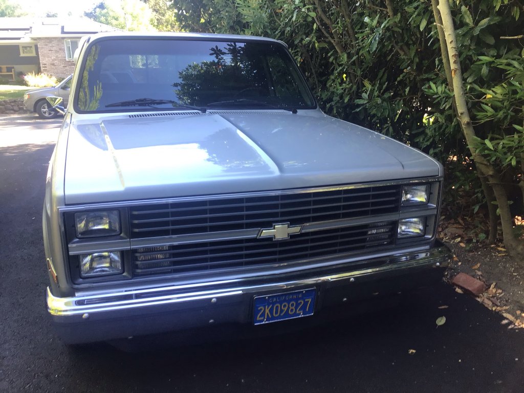

It is a little darker. Mine is a GM reproduction from LMC, very pleased. Had the center painted with the truck, favorite grill as well!
