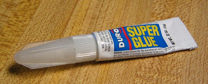

This is all I have to offer, haven't really looked at mine...
attachment.php
