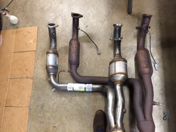

Old versus new...... The old appears to have smaller cats than the new. The swap was rather easy and trouble free.
