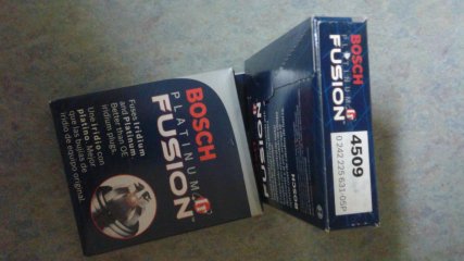

Anyone ever use these plugs? Can get a set of eight with wires for $35.00 but I am not sure about them. I have always been a die hard AC Delco plug guy for my GM rides. Plus Knowing the spark will only jump one gap at a time I feel the four grounds is more of a gimic than a benefit.

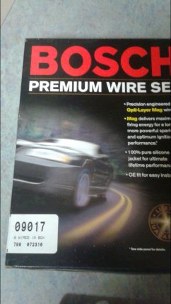

Yup! I am fried for the day. Heres what I mean.

And these wires. I can get the plugs and wires for $35.0"

mistaake
Mar 20, 2015
651
19
SF Bay Area, California
Michael
1999
Crown Vic
4.6
gotta use acdelco plugs anything else might have problems

my friend tried to run e3 plugs in his 02 gmc envoy 4.2l straight 6
FAIL
my rule of thumb has always been
AC Delco = GM
Autolite = Ford
Champion = Mopar
flyboy1100
May 23, 2014
1,024
11
UsA
me
k1500
305, 700r4??, 3.42 gears
Mine has been
NGK = everything
