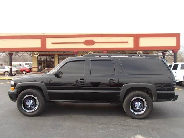

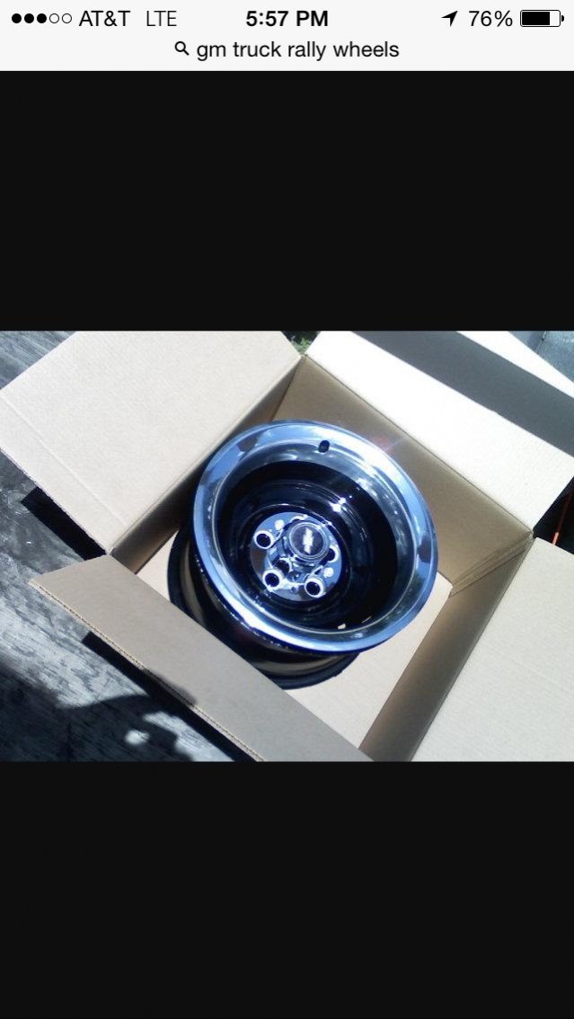

How do yall think Lucky would look witht a six bolt sixteen inch set of these with 275-75-16 goodyears on it?

So I did some cut n' paste to see what this would look like. the proportions are not correct but the concept is there. Thoughts?

I like the idea. Obviously the wheel you're using is a 5 lug and your burb is a 6 lug. Also, you'll want to check that the old rim will fit over the hub of the burb and I do believe you have to use a 16" or larger rim due to the size of the calipers. Just some things to think about.
Yeah, going with Stock steelies with rings and caps from a 98 GMC K1500. gonna paint the wheels black.
I couldn't find a pic of that setup on the interweb thingy.
29,058
11,596
:waytogo: I look forward to seeing the look. No many people do it so it's good to see different :)
Right, I have had to try and imagine how it would look. I don't want to go too retro on this body style but the 20" just scream Pimp to me. plus It need to go more places than parking lots and wet grass.
