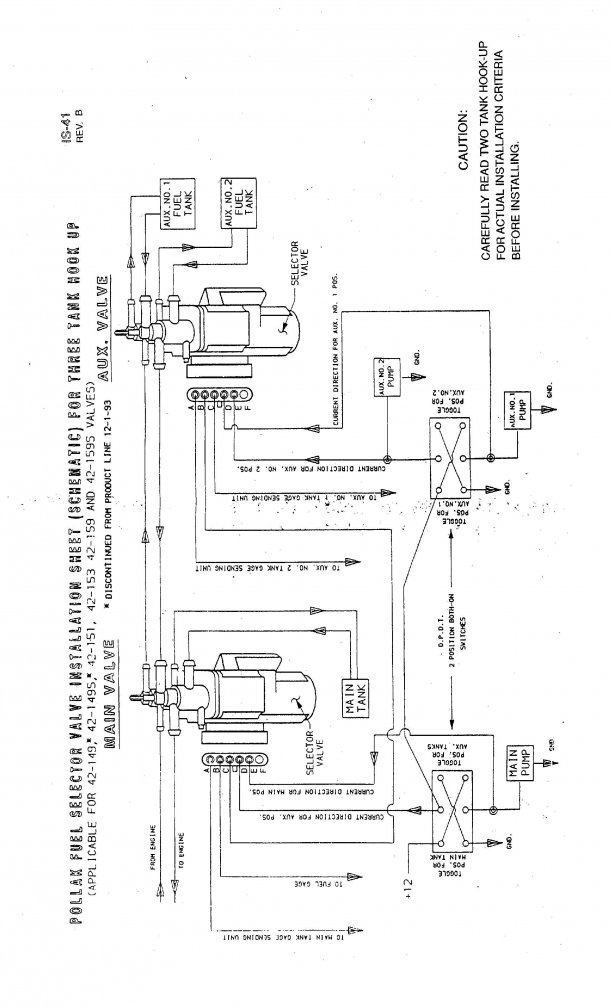

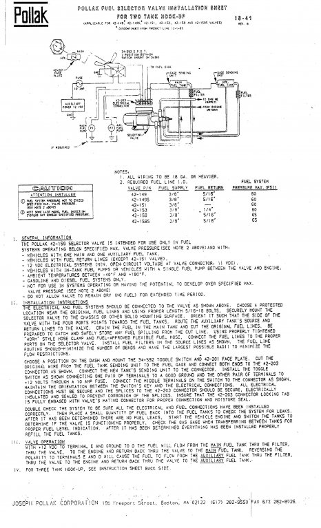

Just a thought, if it’s using that much gas, and you are deleting the spare tire any way for a 40 gallon tank, you could go nuts and make it a three tank system, or keep the saddle and make it a dual tank. It is just wasted space if you don’t. Sounds like that saddle tank has to come down either way. I agree, it’s probably bad fuel lines someplace.
Plenty of us can help you with this mod if you want. Pollack valve is about $90
It's a Suburban so no saddle tank and no spare tire delete, it's a rear tank mount.
