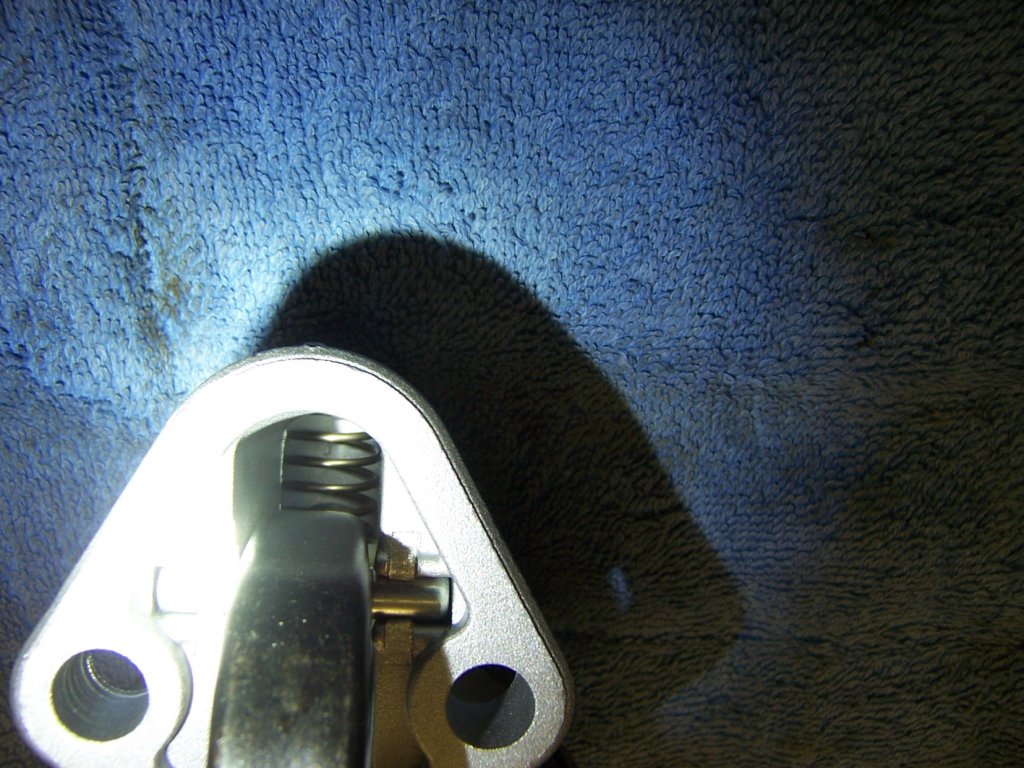

Need some advice on my 86 k10 305. I have been through 3 fuel pumps since starting to restore my 86. The first a return spring broke, the second the diaphragm ruptured, and the third is now losing prime if it sits a week and when my son drove it yesterday it quit on him when he was driving down the highway. When we got there to get him it looked like it was vapor locked, no fuel in the filter. So I removed the line from the carb reprimed the pump and it drove all the way home. Does anyone make a decent mechanical pump anymore, or should I go the electric route? Mine is a 3 line pump, should I try a two line without a bypass? I don't remember the brands of the pumps, but two are from Napa and I think the last I bought at Advance. Just looking for advice on what others have done that is reliable, because these China crap parts are not making me happy at the moment. And the whole fuel system is new, from tank to pump to Edelbrock carb before anyone asks.

Delphi or AC delco. Went through 3 before I figured out what was going on. Cheap pumps did not have a return spring on top of the pump arm. Even though the GM pumps are made in China they are different.

That's my original suggestion. Buy Delphi or AC Delco. Pumps without the spring, pump arm would stick 1/2 way or more down and didn't make any noise.
When accelerating on the freeway truck would shut down until throttle was reduced. Basically replaced the entire fuel system then took pump off and checked it. Replaced 2 more pumps that did the same thing. Until I found a pump with that spring, they were no good.
