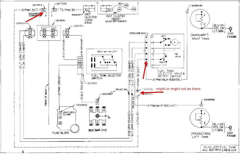

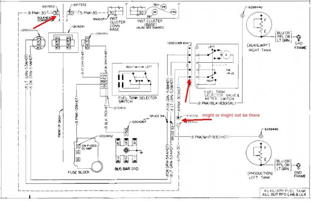

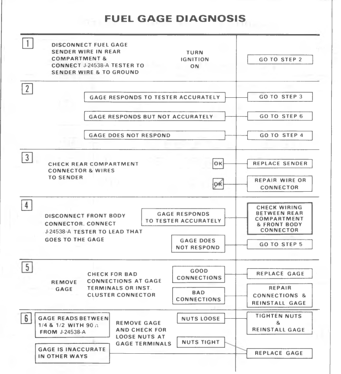

I'm guessing the gauge, but it wouldn't hurt to also check all the pink wire's connection points.
