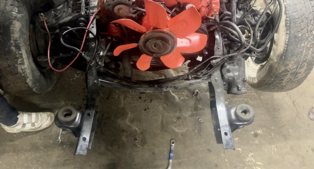

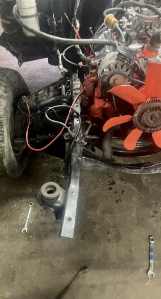

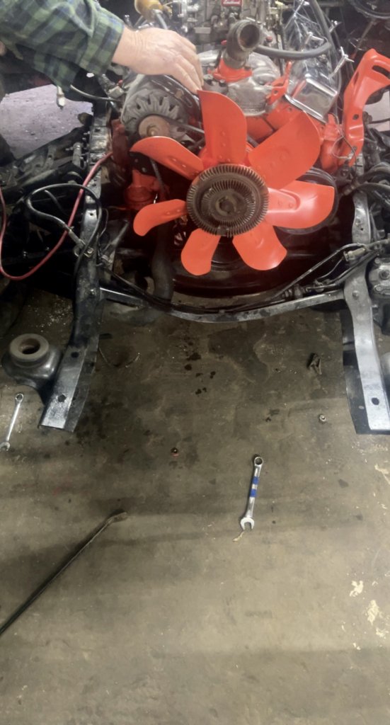

Is the front frame bent?

I would use a measuring tape and "X" it out. Measure front the front rivet on the passenger side crossmember to the center of the bumper bracket bolt hole on the drivers side rail, then repeat on the other way. If it's square , the measurements would match. I have a funny feeling they will not

my guess is the passenger side has a definte bow in it

It looks bent to me. Any signs of a crease on the outer vertical wall of the rail?
Will a bumper easily bolt on? If not, you have your answer.

I’m going to try to bolt bumper on. Is it worth fooling with or junk it?

Looks like it's just the front horn, that'd be very easy for a bodyshop to straighten out. I'd get 'em to pull it and move on

If all of the damage is forward of that front crossmember I wouldn't be afraid of it after it was straightened. As stated, you need to spend some time checking the frame to see if it's square or not behind that crossmember.

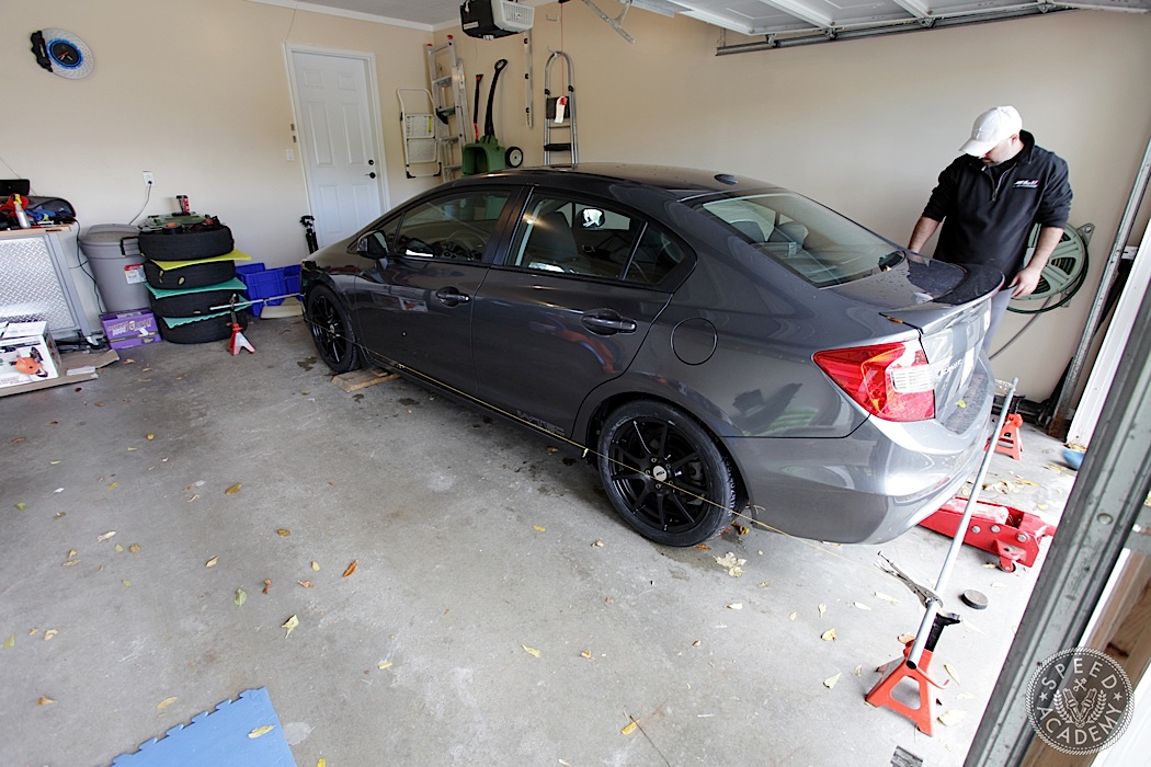

Do you know how to build a string box for doing alignment? I'd build a string box,center it using the wheel hubs as as locators as in 5in to lf hub 5in to rf hub 4in to lr hub 4in to rr hub, just example numbers. Then use 3 4 5 formula to make sure your frames square. If so then you can take measurements side to side to see where right front needs to move to. I'd probable move it myself.

How to make a string box. Similar to mine I used conduit just looked up a link for you,never thought pvc.
Okay this is more like mine sorry trying to find u stuff spur of the moment.

Look at the bottom link of post 14. You could add a center string under the truck but you'd have to make some short stands for the conduit
