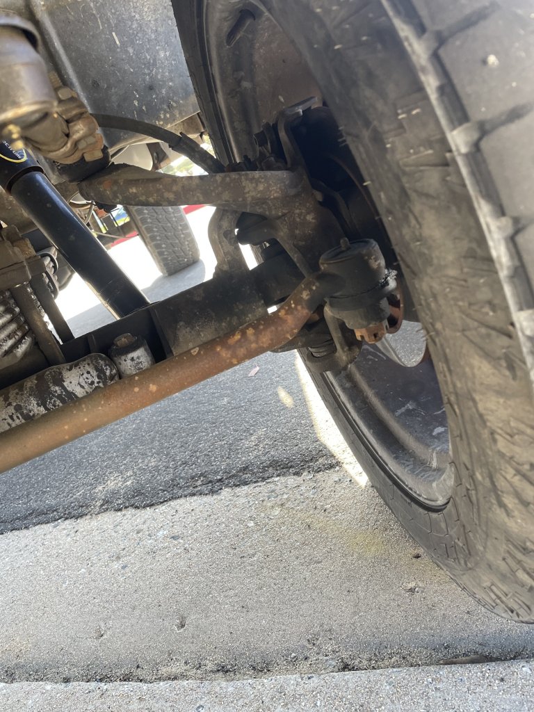

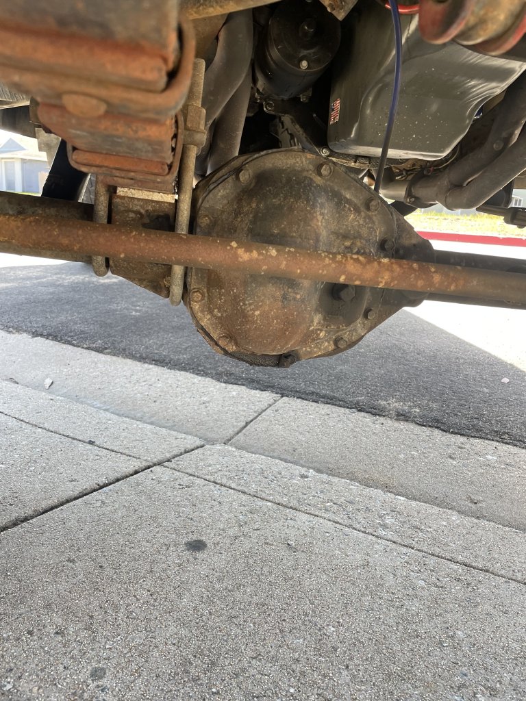

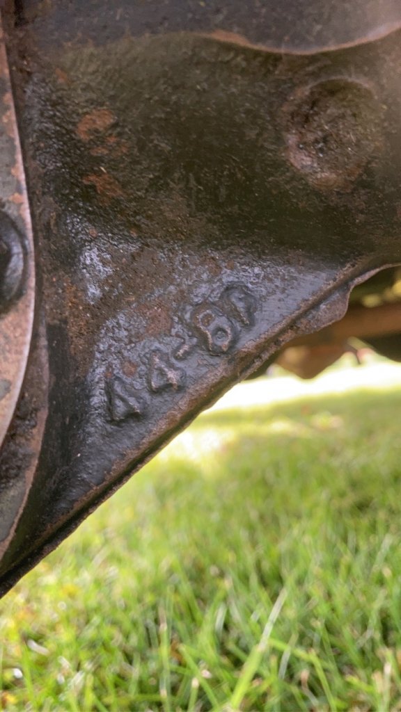

i need help identifying my front axle. is it a dana 44 or 60?
i have disc brakes if that helps. i am missing my front passenger axle shaft and i need to find which part to order. if you have a part number for me that would help greatly.

I believe you have the Dana 44 front axle.
Edit: What @Blackbeard44 said....

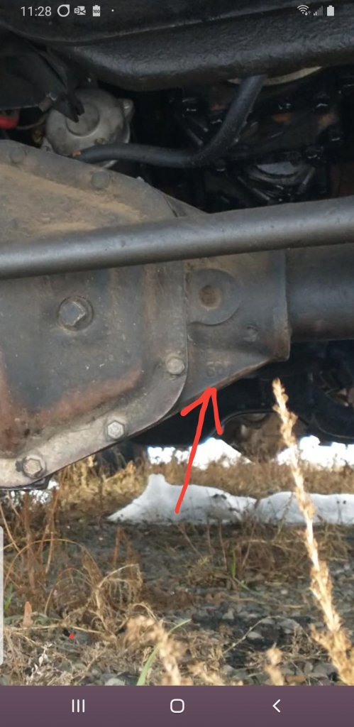

to the right of the drain plug and down twords the bottom of the housing if it has a 60 stamped like the pic here, it will be a Dana60

That looks like a 44 to me. A 75 K20 would only have a D60 if someone swapped it in after the fact, what makes you think it might be a 60?

if your looking to replace an axle I would remove the cover and verify there isnt debris in there, and count splines just to make sure you order the correct one, GM dana 60's have king pins instead of balljoints, I'm going with Bextreme04 on this one and think its more than likely a dana 44

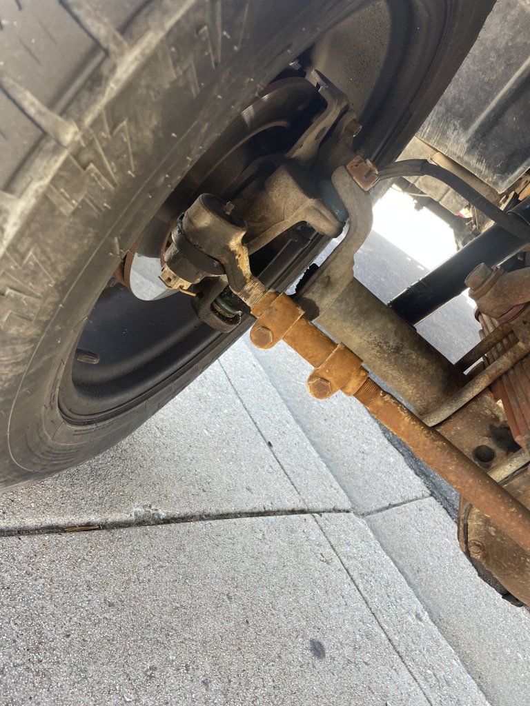

yes there’s a lot of questionable things with this truck. but for now i need to get an axle shaft. do you know a part number i can use? is it bad to drive it without it?
you can see it in the first picture missing

Its a Dana 44, if it were a Dana 60 you would have kingpins for the upper ball joints.
IIRC, GM started using them in 76 or 77. Before that it was a Dana 44.

your axle looks like its from something not a GM
heres a rear d60(so you know variety exists)
your d6_ (I can see a 6 at least) looks like maybe it came from another make?
