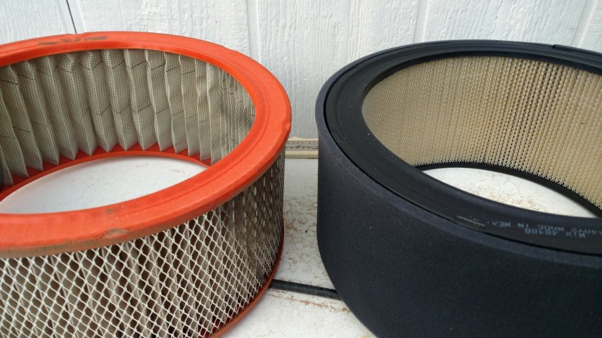

Can't tell any difference while driving. Seems good, I'll probably replace it with the cheaper Fram when the time comes and wash and reuse the foam.
They are cheaper for a reason. Look at the number of pleats in those two filters that are in your picture.

Yeah but they've always been good enough and now with the foam outer wrap I like my chances even more.
We'll see though, I'm still weighing the $10 vs $25 difference.

I'm just saying, the one that costs twice as much will last about 5 times longer. And it's nice if you end up spending a lot of time on gravel roads for any reason, you don't have to worry about the cheap filter plugging up.

Also, look at the buckled pleats on the orange filter. That's often from having the engine trying to suck more air than the filter can deliver.

I actually found that it's from the missing rubber gasket between the airbox lid and the base. So by me tightening the crap out of the wing nut it started to crush the filter before the lid seated.
