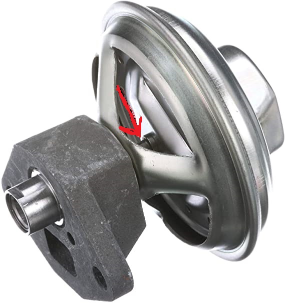

Ill go to a junkyard and get a ton of parts in a day or so. For now, I want to see if it could be the EGR valve stuck (I don't think it would be because it ran fine w/o MAP but hey). Should I be able to move the valve by sticking a screwdriver into where I have the picture and pushing it up and down?

That will work but usually just reach inside with a finger and pull it up. If it doesn't change either the valve is open, or the passage is plugged.
