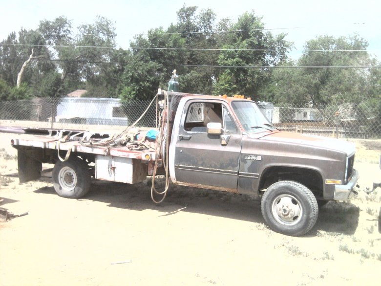

hear is a pic of one of mine

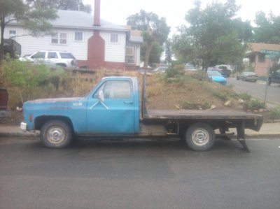

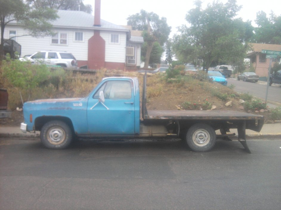

with a flat bed I really don't care how it looks its all about the utility of it to me as long as its not a cobbled up mess.
that is a factory built bed I just threw it on and ran with it
my other flat bed is even uglier
