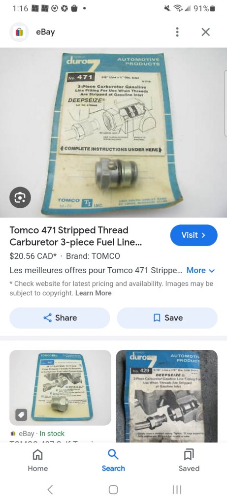

I went over everything on the top end and found the carb mount bolts weren’t fully snug. Fired right up and running normal. But ran into another problem. Leak at fuel filter. Tightened it and it stripped. What would a guy suggest ?

How do you put out a fire in a carb?? Crank the engine with the coil disconnected, it will suck the flame out...after-all these are fire breathing engines...
Last question: a good carb shop may be able to put in a Heleocoil or retread it for a larger filter.
Rich
6,462
10,998
Helicoil , You can do it. They do or did make oversize self tapping inlet fittings, its ghetto,but it's not my carb. Okay I think I'd try a Tomco 471 fuel inlet. No tapping UT seals with 2 Owings and compression. It's less than a helicoil kit and more DIY friendly
