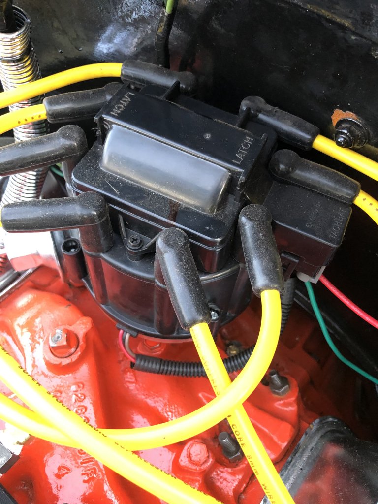

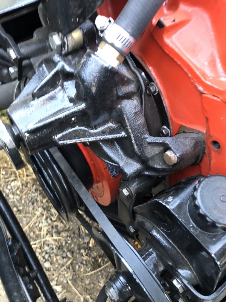

so went out and pulled # 1 plug put a *** of cotton in the hole cranked it with my remote starter till the cotton shot out so #1 should be at tdc looked at the timing mark right on 0 pulled the cap rotor pointing at what looks to be #7 but could also be#1 here are pics

to everyone who has suggestions I wanted to clear up one thing the truck doesn't run it will fire over but with fire shooting out the carb I figured it prudent not to continue running it.
