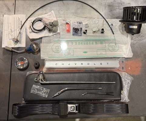

Interior stuff stockpiling. I want to get what I’m immediately looking at in the truck when I’m driving looking nice. Then I’ll worry about floorboards. Gonna have the interior paint matched so I can paint the dash and maybe some other spots

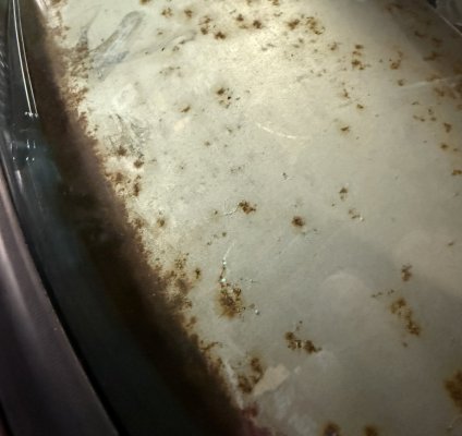

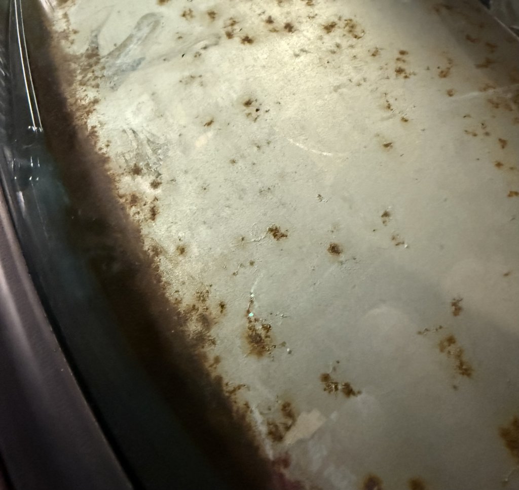

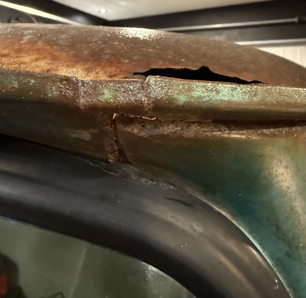

That color actually came up in a Google search that I did. I’ll get a few cans. I really wish I had prepped and painted the interior while I had the windshield out, there’s some pretty good flaky rust at the bottom of the dash by the windshield rubber. And I’m sure it all comes from this spot on the driver side up high that’s letting water in. Or if it’s not now, because of the new gasket, it was before. But if I had the glass back out, I could fix that piece up top and really prep and paint the dash like it needs. I just hate to pull it out again. It could break easily going back in. Maybe I’ll just tape it off and get it as best as I can. This ain’t no show truck.
Crusty's ceiling was like that with tiny rust spots inside. I spent a weekend with No7 polish and sore shoulders to buff them out. That was before I found that paint. I think they sell roof skins. I need to do Crusty's roof skin, too.

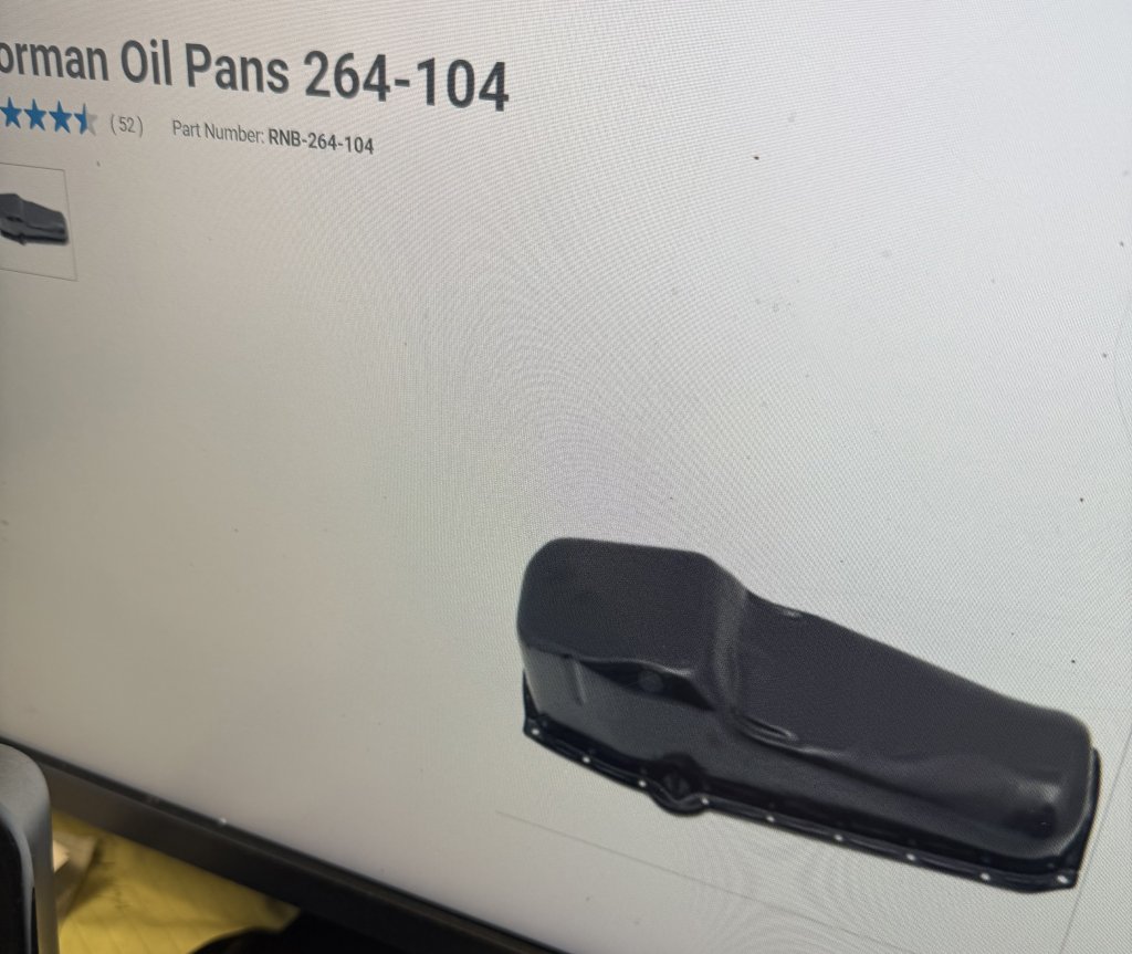

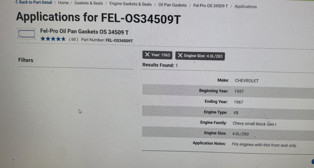

Also, it is a pretty damn good oil leak from that old pan gasket upfront. I’m starting to wonder if my gasket and new oil pan are made for each other. I need to go back and find the part number for the gasket, and make sure it’s for that 60s engine. And I need to find the part number for the oil pan, and see what year it’s for. I mean, maybe they’re the same for the last 70 years, but then why would they have two separate oil pan gaskets? Anyway it’s definitely going to have to come out before I drive it much again.

Oil pan gasket I have

Pan I have

Looks like DK is '63 or older, with 2bbl and automatic. There should be a date code on the block, if you want to narrow it down. What is the head casting #? They are later heads, with accessory holes.
Any cross hatching still visible in the cylinders?
Where is the table for identifying these numbers? I check the squarebody ref library but didnt see a sub forum for this

So I have the wrong pan gasket
