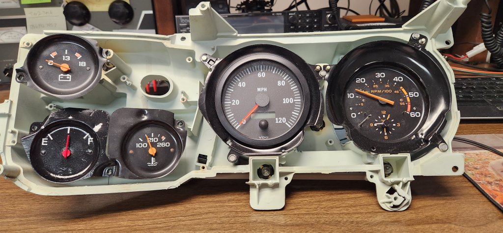

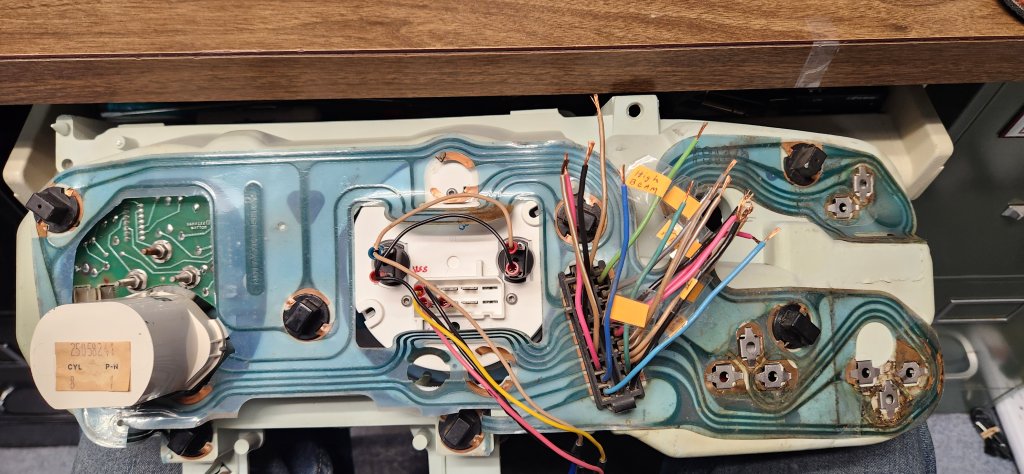

Made my own, Closeout VDO speedo from YOGIES, tach and clock from 84 to 88 Monte Carlo. Have to graft them in with Weller soldering iron with plastic melting tip, took took speedo and gas gauge out, removed the guts and cut centers out with big hole saw. The VDO would fit the opening with a little trimming, but the tach had to be JB Welded to the back. Time consuming,but works.
