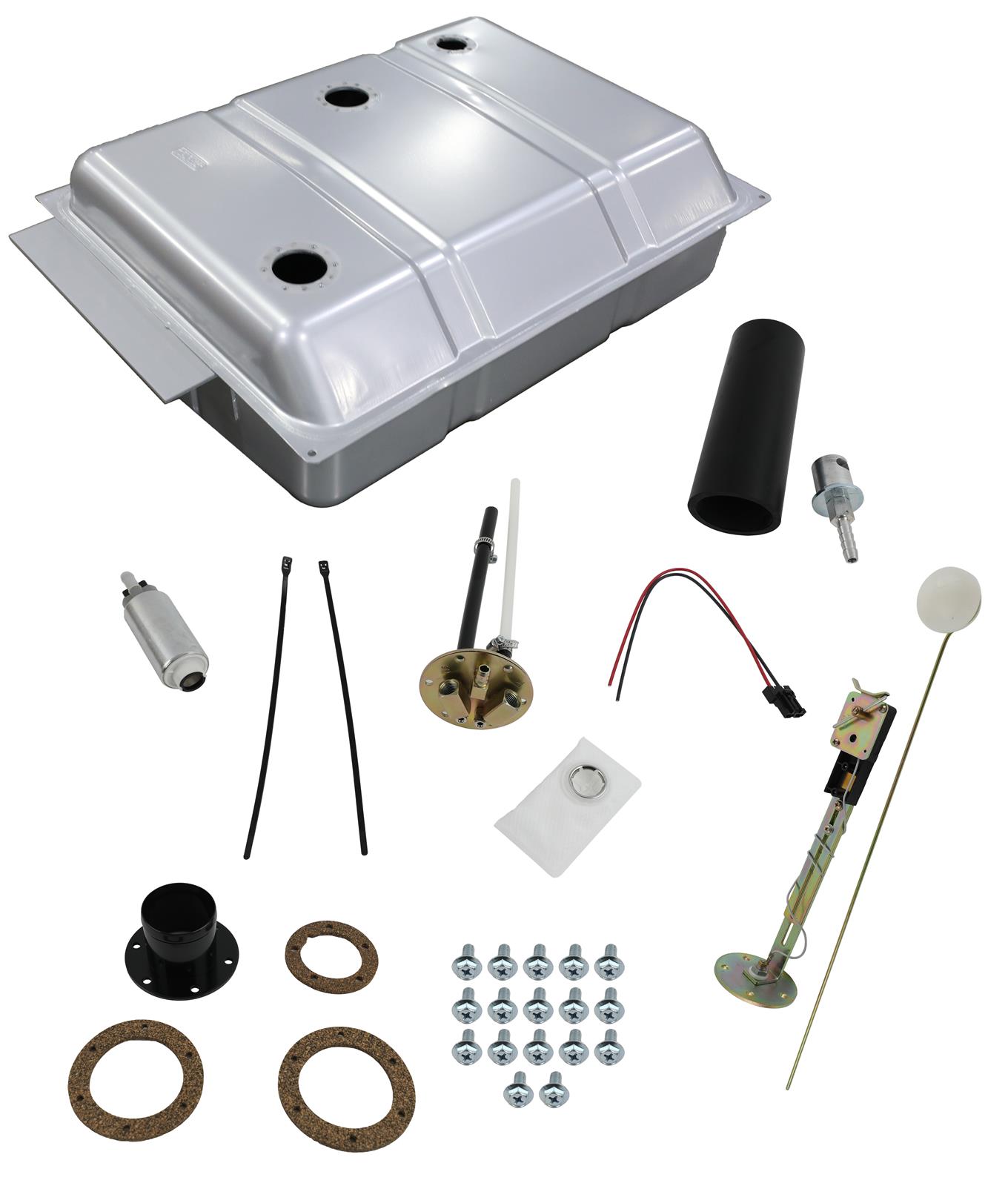

Buy Spectre tanks and senders for a 1987 model year. Use AC Delco EP381 pumps on the 87 senders. This will be the most reliable option to run dual tanks.
I did not have a good switch, so I have my passenger side tank plumbed as an auxiliary tank, meaning it pumps into the primary tank when switched on. This requires a little bit more attentiveness, but eliminates the tank switch and somewhat simplifies things. I rarely use the passenger side tanks anyhow.
Also, keep in mind the fuel lines. They were not designed to run 60psi. Most EFI systems call for a 3/8” supply and 5/16” return. NiCopp line is easy to work with and is ethanol resistant. Other than that, choose your favorite EFI flex line and AN fitting manufacturer and have at it. Regular ol clamps can be used, provided they are the EFI style ones on the appropriate flexible hose.

I will not be replacing the tanks, as I recently redid the entire fuel system for the 350 that was in the truck, before I decided to switch to EFI with the new engine. I put in new tanks, sending units, lines, a switch valve, and a mechanical pump when I redid the system.
Fair enough, I was just presenting the cheapest option for long term reliability for the fuel pump itself. In tank pumps are cooled by the fuel, so they tend to live a bit longer.
