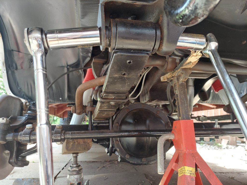

I added washers to mine and they are the same diameter as the pin hole. I have mine more to the centre just to keep it away from possibility of rubbing on the tires. Feels fine on the road.
