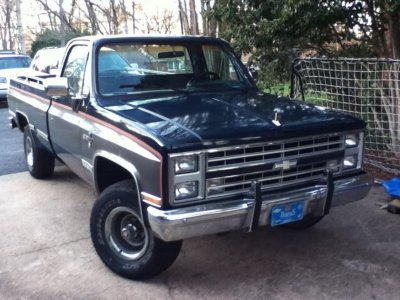

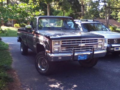

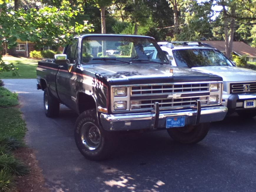

finished the add a leaf suspension today, and i like the mild lift it gave. 2 things to note. the centering bolts included SUCK. they stripped before i even tightened them to the recommended 32 ft lbs. so i had to use some different bolts, went with grade 8 bolts :crazy: and also with the 2 inch add a leaf the front springs can extend the shocks to full length when just barely more than level height. so contrary to what ive been told 2 inch add a leaf lifts need new front shocks, although they should be fine for now. here are the before and after pics.
before
attachment.php
after
attachment.php
for 160 bucks i'd say not bad!!

Not bad buddy! What's the rake look like? You gonna have to add a zero rate add-a-leaf in the back to level it out? Cant really tell from the pics.

sometimes i think it looks even and sometimes it looks a little off but i think im going to leave it because it is so close to level. my mind could be playing tricks on me though because i had the rear on without the front for a few days so maybe i was getting used to it with the back higher.
