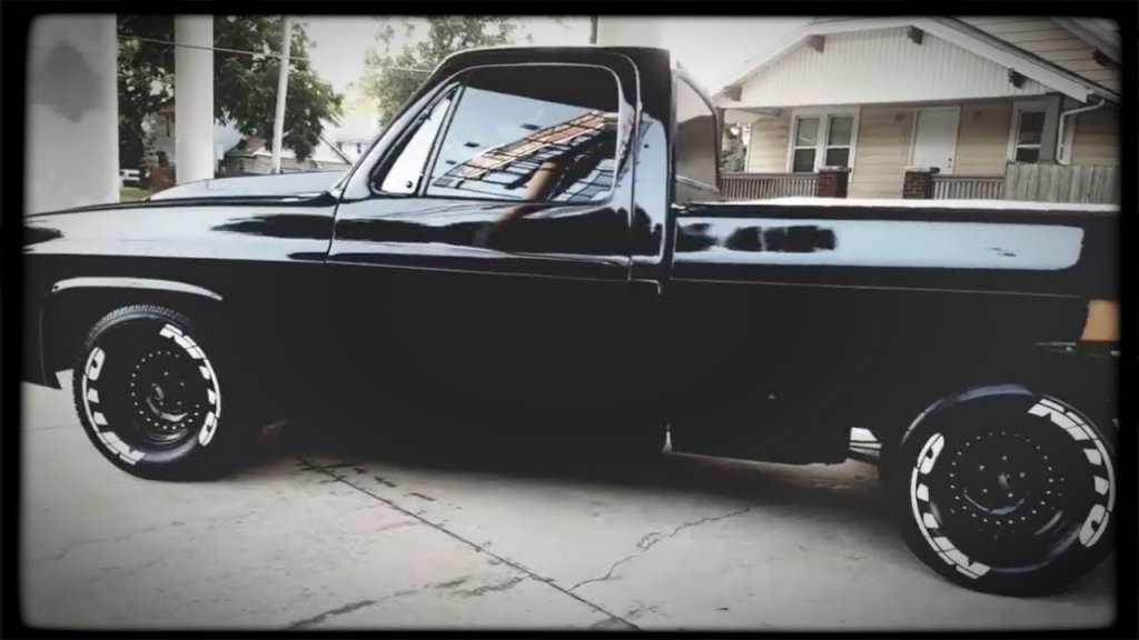

Does anyone Know What size Tire and wheels this truck has?

Does anybody know the Tire/Wheel details on this truck? I have found the breakdown for everything but that. This is the size I want, I have asked different website but no luck. Any help is appreciated. I have searched the forums as well. No Luck. Again Thank you!

Really hard to tell in that picture. The wheels look like American Racing Outlaws, painted all black except for the rivets. Maybe 15x8 front and 15x10 rear. Looks like a BFG Radial TA up front, maybe a 275/60. The rears look like a drag radial, unsure of size.
Obviously, they are not actually Nitto tires.

I couldn’t tell by pictures either. Like I said, they give a build but no spec on wheels and tires. I know of few people who put 15x10 up front. I really like 17’s but there is just something about 15’s I like. Maybe it’s my age. I am getting old.

Update, I found a way to duplicate these wheels but in the outlaw 2. If I am running a 2.5/4 drop on an 86 c10, will 15x8 wheels with -19mm (3.75) fit under the fender? And will it clear the lower control arms. I need to purchase soon. Any help
Is appreciated. I read the different posts but they are not clear.
