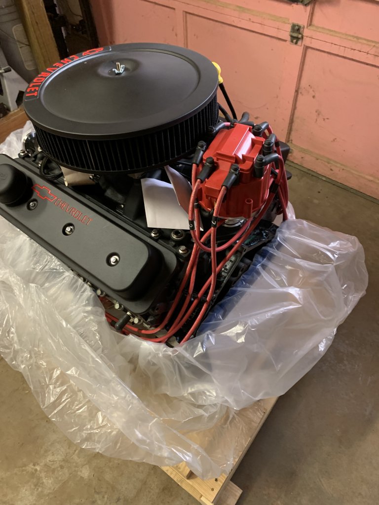

I am swapping engines. New engine has HEI also.

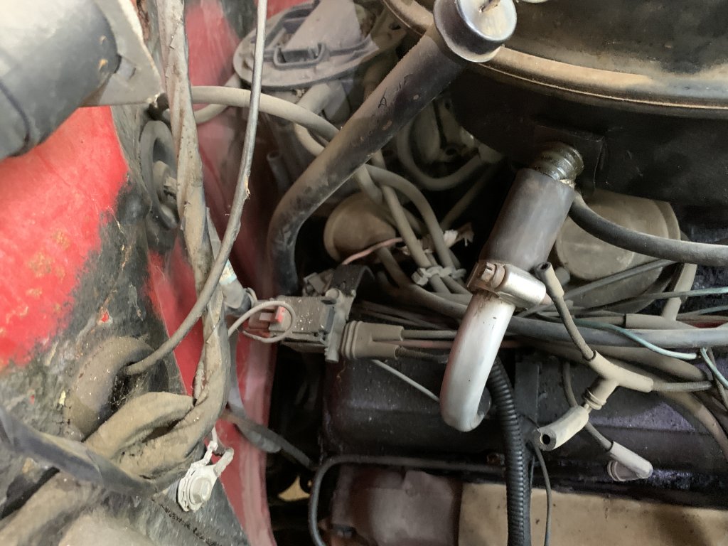

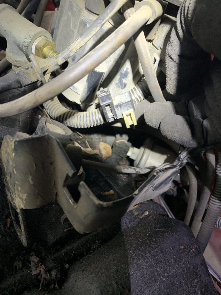

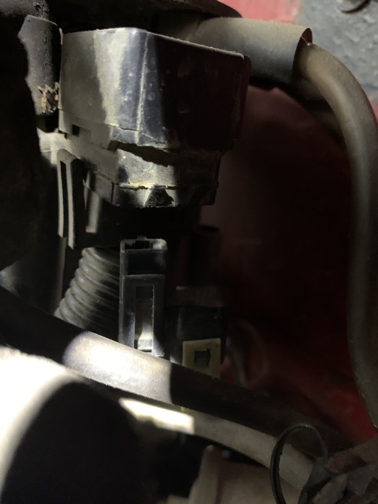

The distributor had a combo connector into the ignition slot. Black connector runs to passenger side. White connector runs to drivers side.
My guess was that black went to esc and white is ignition.
What are these for? Do I need both? Can I leave off black if not using esc?

Thank you. Do you know why the truck originally had what seems to be 2 wires connected to BAT on distributor?

Agree that’s all I should need. But this truck has a second wire tied into BAT and goes into factory harness. So I’m trying to figure out what the 2nd wire goes to and if I need it.

It is definitely an original factory connection and was not the choke wire. Choke wire is accounted for.
I have found 2 wiring diagrams for square bodies. 1 insinuates it goes to esc other insinuates that it goes to speed switch valve. But I can’t find it in a wiring diagram specific to my truck.

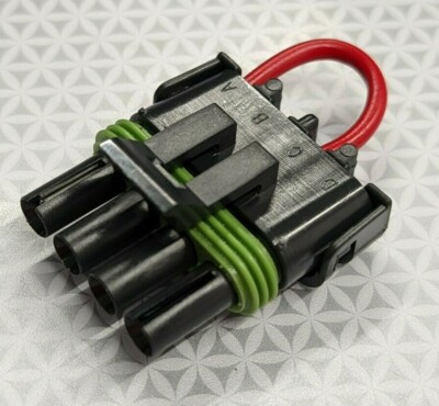

Not quite certain but I thought I read that the ESC was a 4-wire connector, so I bought a by-pass connector just in case for the ESC and it is something like this:
Hope I bought the right deal though.
