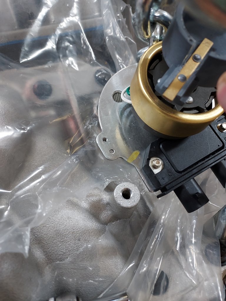

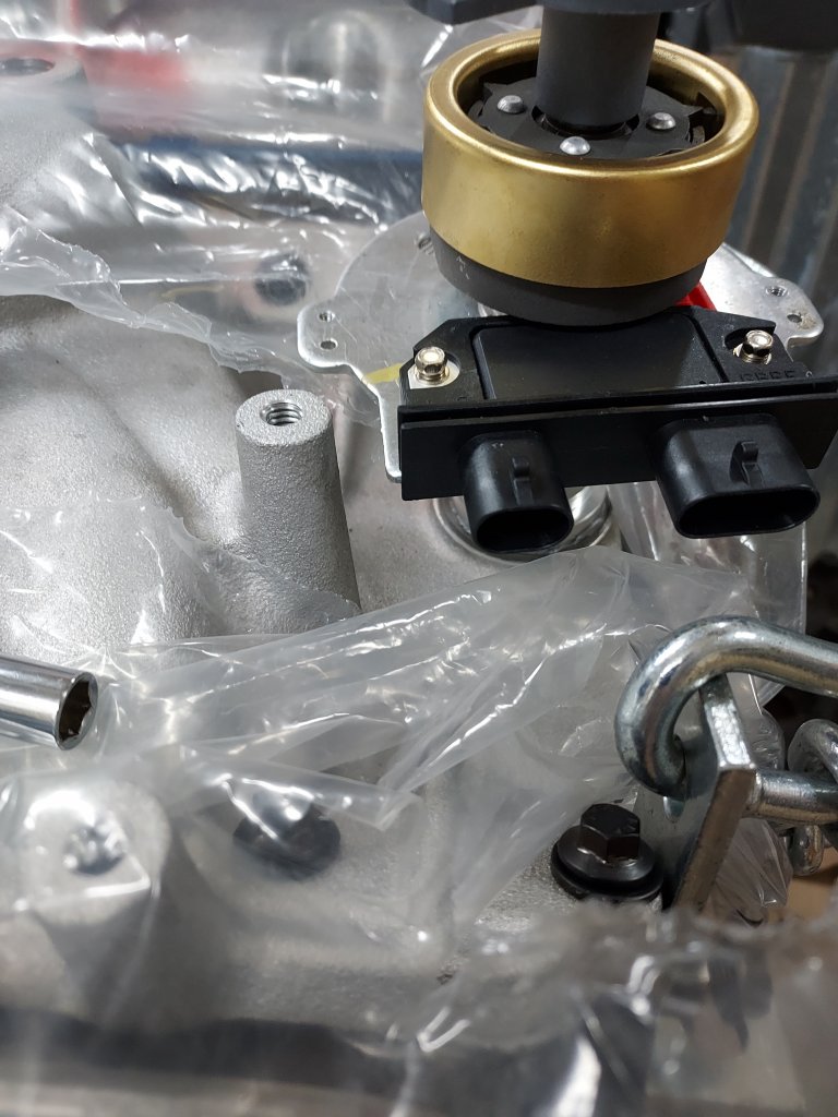

The distributor will hit the mounting post for the coil, as this post sits higher.
New distributor is same height as old.
I might have 3/8-1/2" if we have to advance distributor timing.
Anyone run into with this intake?

Are you not able to set the ignition module on the other side of the post?

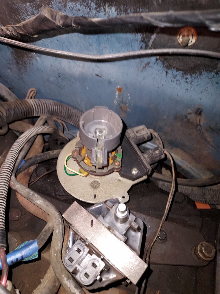

The distributors were typically installed when new, with the module connectors pointing more towards the firewall. Doing that will provide the needed clearance.
Yes sir, that's what I saw from my saved pics. I had e builder stab it.

So here was the original, and I hoped new dizzy would line up same way.
No sir special shape and cap fits that.
The dizzy, ignition module needs to be pointing more toward firewall. I've just never stabbed one and trying to make sure I understand it.
