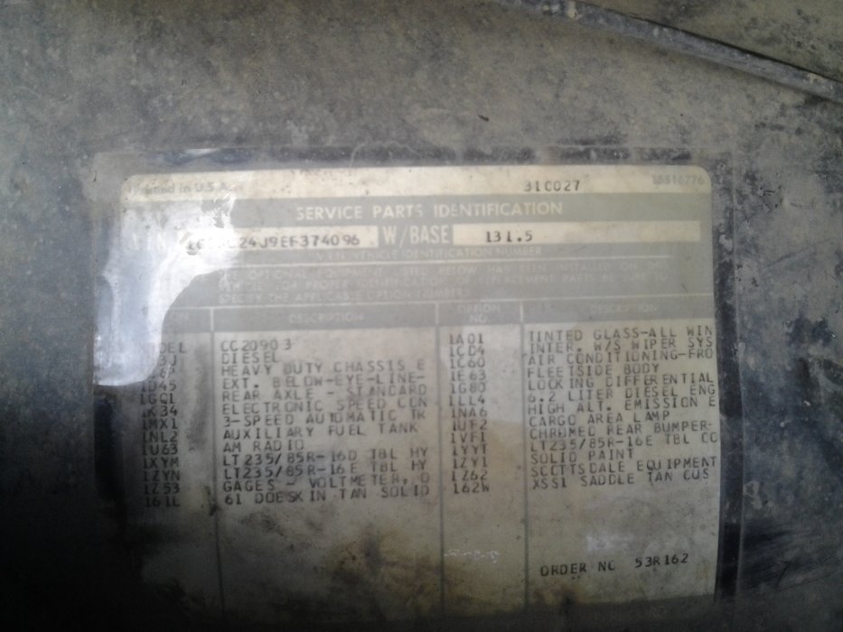

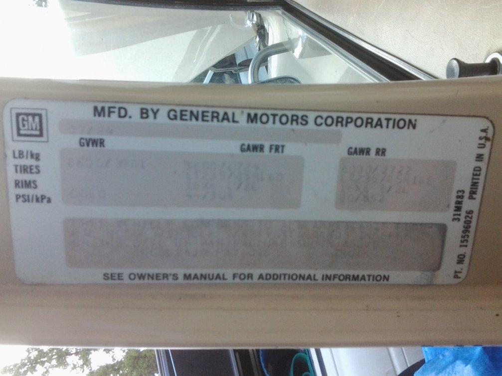

You need to find out which braking system you have to get the right bearings. There is a different set of bearings for the 8600 gvwr brakes vs the 7200 gvwr brake system. My 8600 gvwr C20 used SET45 and 15103S. Be warned that 15103S did NOT come with the race. It needs to be ordered separately. I didn't know this but fortunately ordered new rotors and they had new races.
Brakes codes should be on the RPO sticker on the glove box. 8600 gvwr is JB7. I think 7200 is JB6.

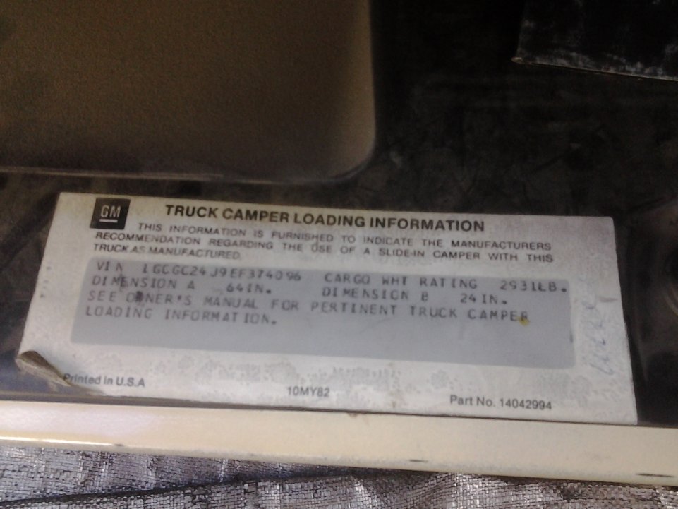

Would that info be incorporated in the VIN? The VIN reads as a 8000 gvw, but the glove box label say camper special, 2931 payload capacity.
This truck used to have a 6.2 diesel, and I was thinking that it might be a camper special and might therefore have 1T hubs and brakes

Here is photo of the tag in glove box, door, and fenderwell
