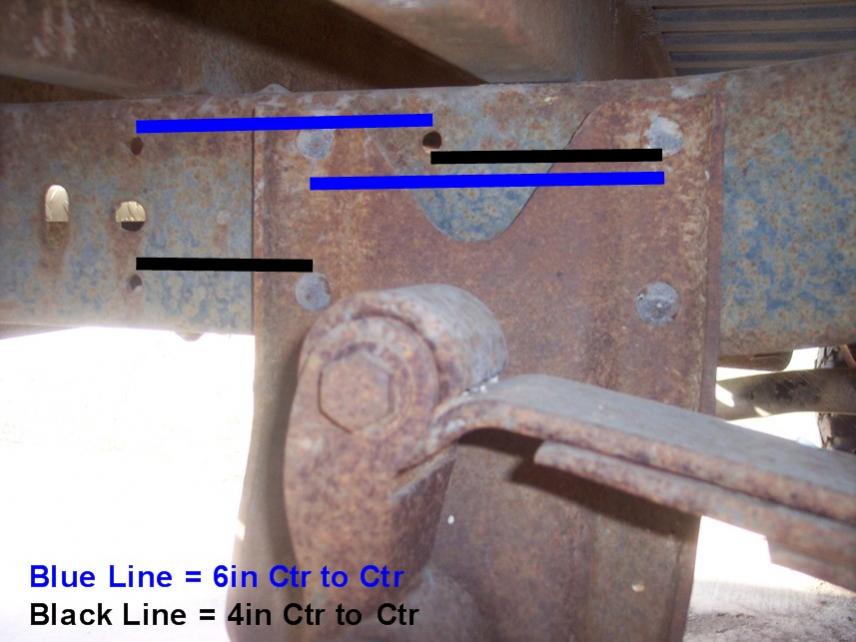

Back to the rear spring hangers now. I just checked both my 85 K1500 and my 85 K10. Both have these sets of holes. Here is a pic of the rear hanger.
Both sets of holes, the set that is currently empty, and the set that has the current bracket mounting rivets are 6 inches a part on center to center.
Now the difference between the empty holes and the used holes are 4 inches apart center to center.
That seems to reason to me, that if I used the set of holes that are 4 inches further back from the current holes, would mean I change from the 52in springs to the 56in springs by moving the same OEM bracket back to the other set of holes.

I am going to venture a guess and say that yes, other than the thickness of the extra leaf, they are going to be very similar in ride height. And even if they aren't I really can't see them being more than 2" different. And that number is probably really reaching. Like C4 said, you can always throw in a zero rate to level it out. Just put in the C20 springs and see what happens. Take a lot of measurements before and after and report back to us.

That is pretty much the conclusion I've came to. The only difference is probably the thickness of that 3rd leaf, and maybe a bit more for a lttle less negative arch. I'll still be awhile since my C20 trucks other than the driver, is out at my dads property. I don't get there very often cuz of gas prices these days.
