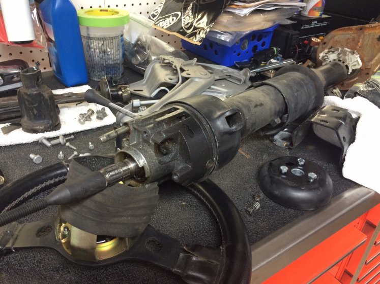

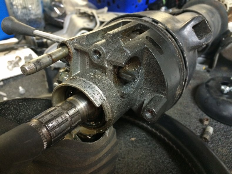

Thats a bad lower column bearing, most likely caused by the failure of the upper bearings. Time to replace all the bearings or the column. Here is a pic of mine with metal shavings everywhere because of the bad bearings. You can fix all like new for $60.00 to $80.00 in parts.
29,127
24,038
I've seen a lot of those lower bearings completely fail and the column was still smooth and fairly quiet while turning. I'd also suspect bad upper bearings.
Does the steering wheel feel loose at all? Sometimes people take apart the column for a repair and don't have the tool for installing the lock plate clip. So they put it back together without the clip to hold it all together. It can cause some crunching/grinding noises and may be a very easy fix.
