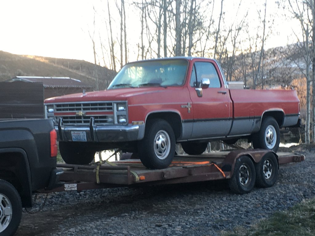

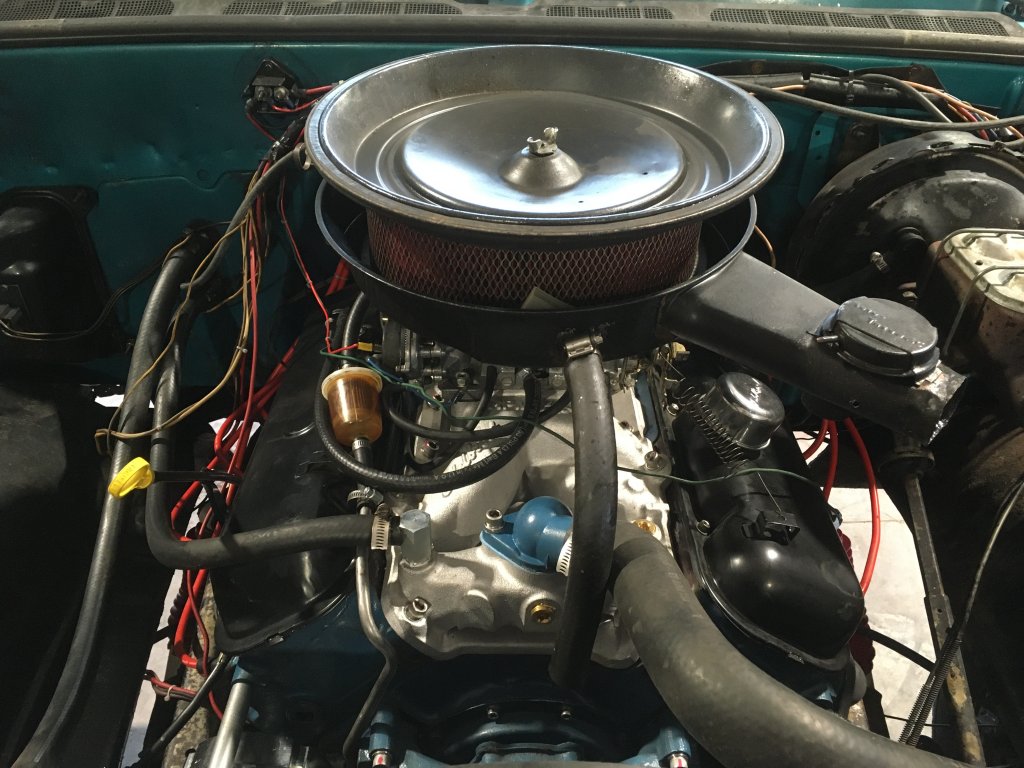

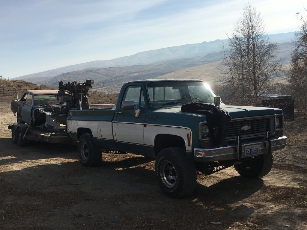

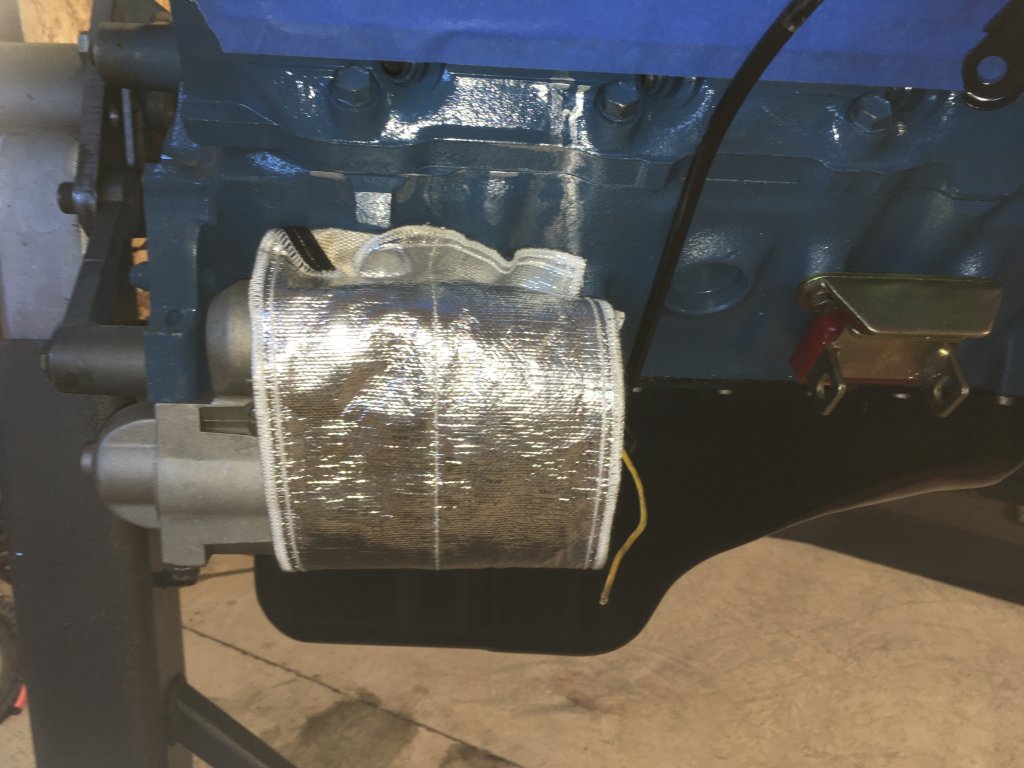

First pic is the motor.
Second is the truck, interesting in that it shows my 64 Nova, the Bridgeport mill, and Cleman's mountain in the background.
Third is the stock starter, which I want to replace with a mini starter, so if anyone reading this, has done this with success, post me.
At this time I think I will go carb, HP 950 Holly, or Quick Fuel.

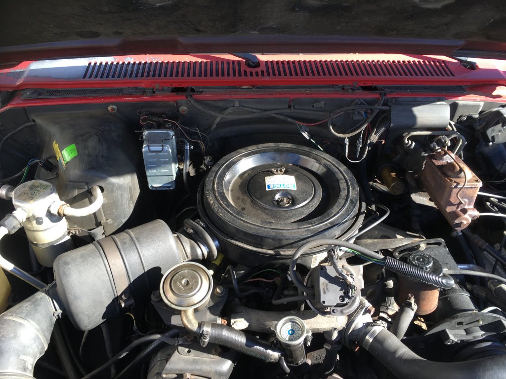

I took the K20m to the body shop, and the 85 c10 to a diesel shop, so things are getting done. While I replaced the starter, batteries, glow plug controller, had the injector pump rebuilt.....I could not get the 85 running. I will run it for awhile as it is, this will be my Bonneville wood hauler.....yeah makes no since. The LQ motor with all the goodies will go in here, but I still need to haul wood.... Well Ol' blue may get pressed back into service, the one on the right in the profile picture.

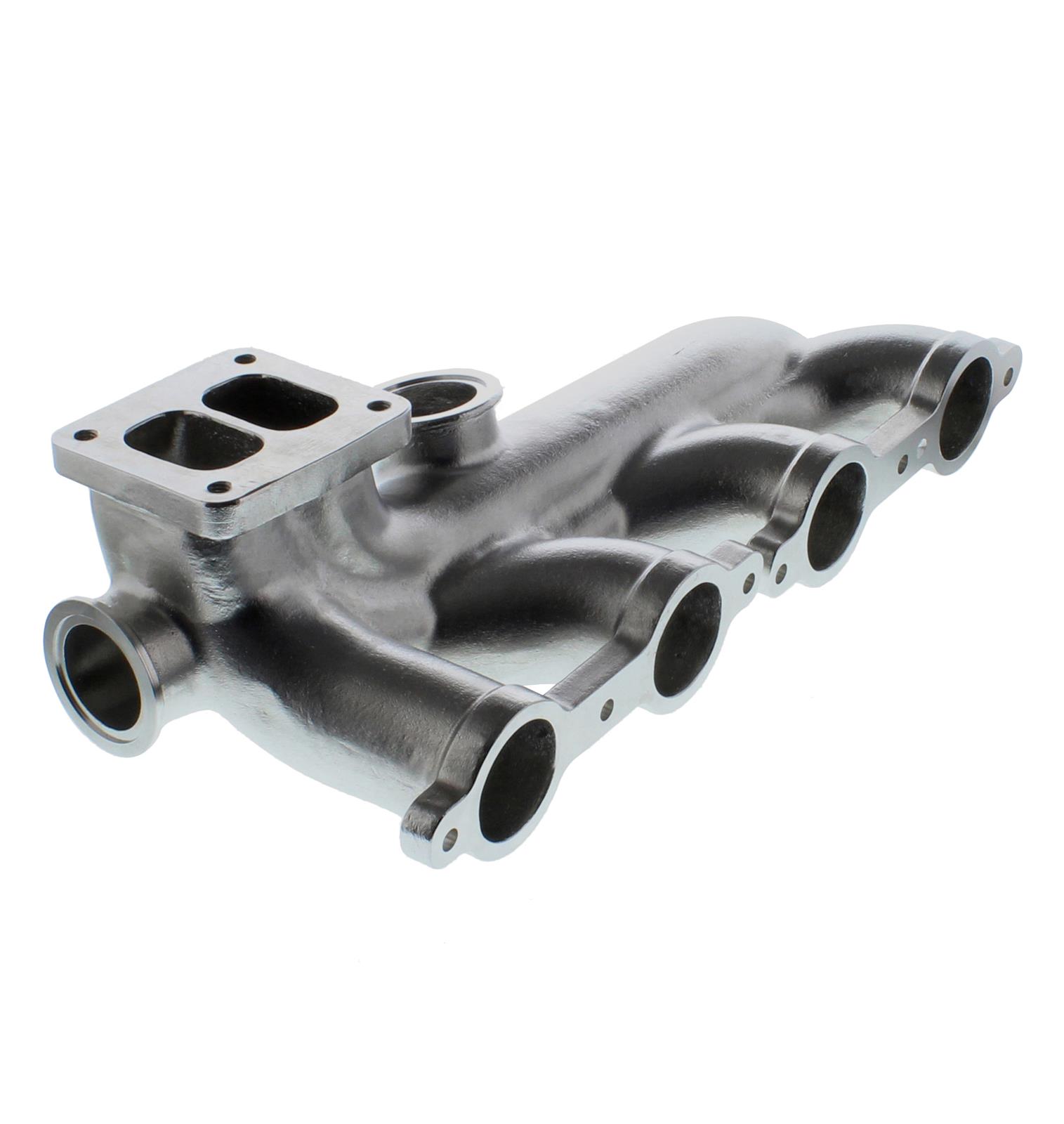

I am looking at turbo manifolds, I like this one because I can use the stock drivers side exhaust manifold.
This allows me to run the two wastegates, but will still need blowoff.
