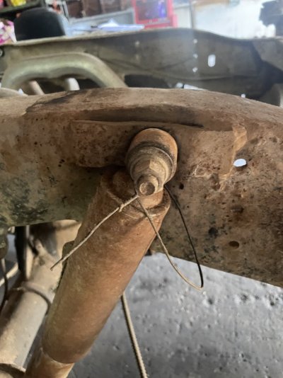

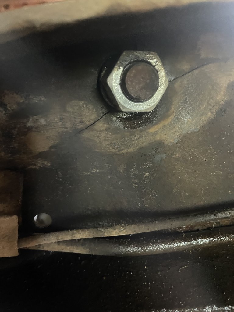

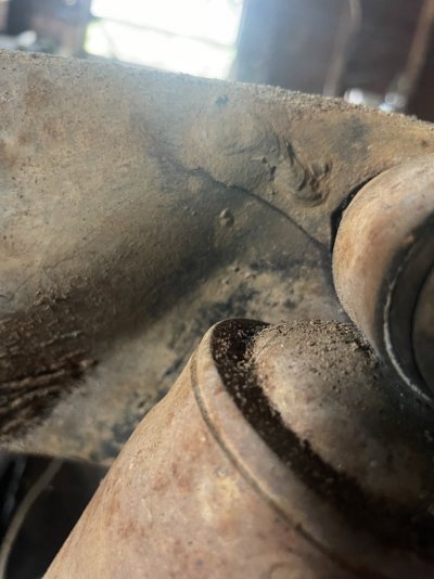

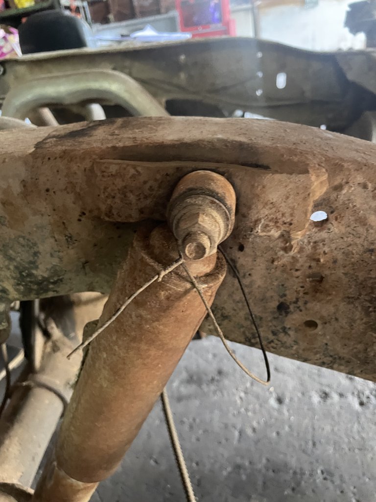

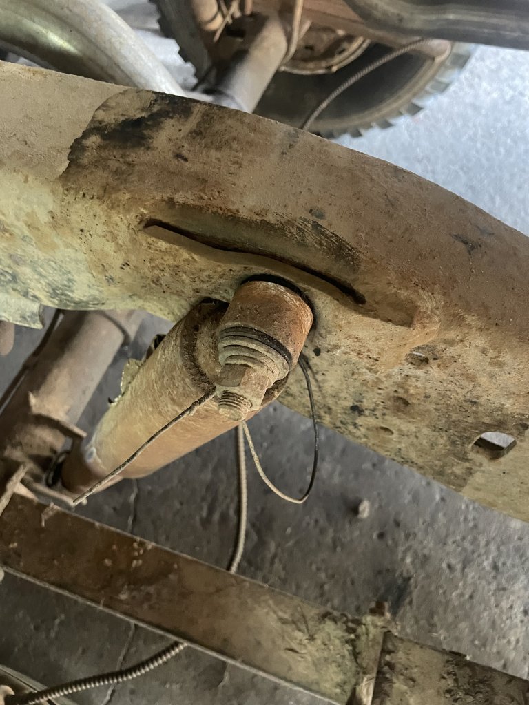

Hello all. The K20 project has been sidelined for a couple of years.. wife and I just welcomed our first child (baby boy) into the family. This truck was my grandpa's and was passed to me after his passing. I'm planning on restoring it over the years and being a truck that my son and I can enjoy as much as my grandfather and I did. I was actually with him when he bought the truck when I was young and it was one of the first vehicles I learned to drive in.

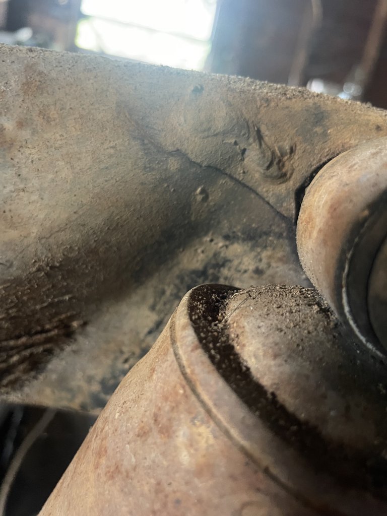

I'm beginning to slowly knock the dust off of the build, and planning on taking my time starting with the frame getting blasted and painted. I removed the bed a few weeks back and took the bumper off today. I noticed that the upper shock mounts/frame is cracked where the shocks bolt up (definitely cracked on the driver side frame rail). This truck is a farm/hunting truck and has been used over the years, lol. I was curious as to any feedback/options going forward.. I'm puzzled as to why the passenger side has a mounting tab welded to the outside of the frame whereas the driver side is just bolted directly to the frame? Are there any other alternative mounting options to help with this issue?Thanks for your feedback. See attached pics for reference.

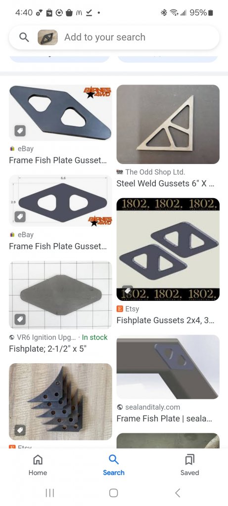

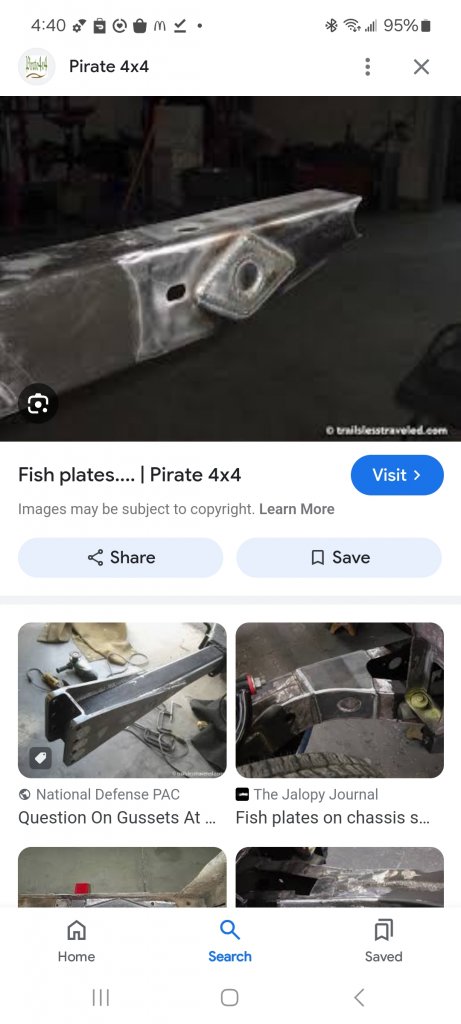

The spots you can,make fish plates plates for,fish plates are a stronger repair than square plates.

It distributes they weld and load at a different angle than the crack, round the ends to prevent stress risers ,and then plug weld in the center on each side of the crack.

Those outside mounts are to reenforce the existing frame mount holes for the shocks.
You’ll need to address the frame holes, add the fish plates, before adding the outside mounts.

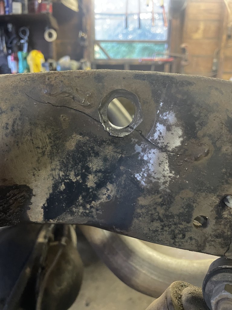

I see. I sprayed the frame with brake cleaner and it gives a better visual of the crack. I’m assuming that the fishplate would cover the whole crack on the outside of the frame, correct? It looks like it would be a challenge to get it to form exactly where this crack is around that mounting hole. Thanks again for your suggestions. I attached this pick for a better reference. Driver side outside of frame rail.

The plate on the one side is a previous repair, as well on the other side the weld is a previous repair. You need to drill out all ends of all the cracks. This will prevent them from spreading anymore, the cracks will keep spreading even if you weld them up without drilling them.
